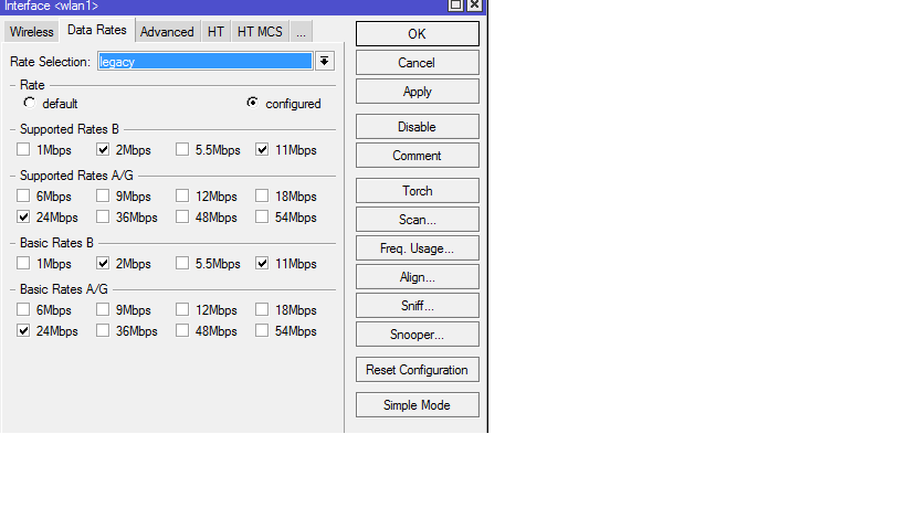

I changed the data rates. see attached.
CCQ still is 70-80%.

you have disabled all rates below 24Mbs. Only disable rates above the max rate you want to allow.
on Client/Station side also should this be done?
I set all my clients to a data rate for maximum CCQ but a AP running on NV2 will ignore these and set data rates for each client.
