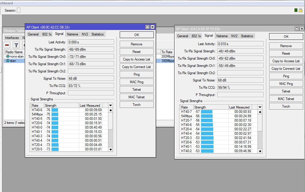

omnitik with 2 clients - ultra slow link, good signal.
recently after my direct-link (p2p with 2 x sxt) went dead because of trees getting folliage (it dropped from 25mbit, to 1mbit) , i contacted a local company which owns the tallest building in town, and mounted on the roof an omnitik. i have clear LOS, 1 sxt is 150m from omnitik, the 2nd sxt is cca 500m from it.
sxt1 signal is tx/rx -49/-49db, CCQ 87/93% , phy rate 300/240mbit.
sxt2 signal is -65/-69db, CCQ 80/70%, phy rate 180/120mbit.
i’m using 40mhz channel, on a more-or-less clear freq of 5580mhz (but i tried on 5450mhz , 5400-5500 is almost clear here, but the speeds were even worse).
when testing speed sxt 1 - omnitik , or omnitik- sxt2 , i’m getting 70-100mbit tcp speed. when i test sxt1 - sxt2, i’m getting 17-20mbit MAX.
i’m using NV2 protocol, but it’s the same or similar with normal 802.11. there is no noise, omnitik say -115db or less.
i can’t experiment too much because i fear of loosing connectivity, omnitik is just an AP for itself, there is no lan connection to it so if something happens i won’t be able to connect.
my question is - why is the speed so low? ros version is 6.33.3 .
a few months ago i installed another omnitik on a different location, also with 2 x sxt as clients, and tcp speed was 90-100mbit on 1.5km, in a crowded area with over 100 networks in 5ghz.
here a 5ghz scan showed 35 networks (i scanned on omnitik during mounting). but it’s not related to noise or networks, as in 5.4ghz band there are no networks, and i had the same problem.
nv2 period is 10ms, but it was similar if kept on AUTO. if i lower the channel to 20mhz, i’m getting max 10mbit. that’s unusable.
please advise.

more like i would like to get info why is omnitik acting so bad? come on, 150m, -50dB signal and it can’t go even 100mbit tcp on wifi??
also, mikrotik bw test from sxt to sxt is giving me now cca 30mbit tcp speed, but when i do a speedtest, i can’t go above 15-17mbit. even worse, local file copying in my network (from the location with sxt 1 to location with sxt 2) is not going over 1MB/s with total commander.
i know how a repeater works, and omnitik in this scenario should work. don’t recommend buying new equipment, a nearby WISP was using omnitiks as base station for clients… the device itself is capable of 150+mbit of tcp bandwidth. and i’m getting 15 !
