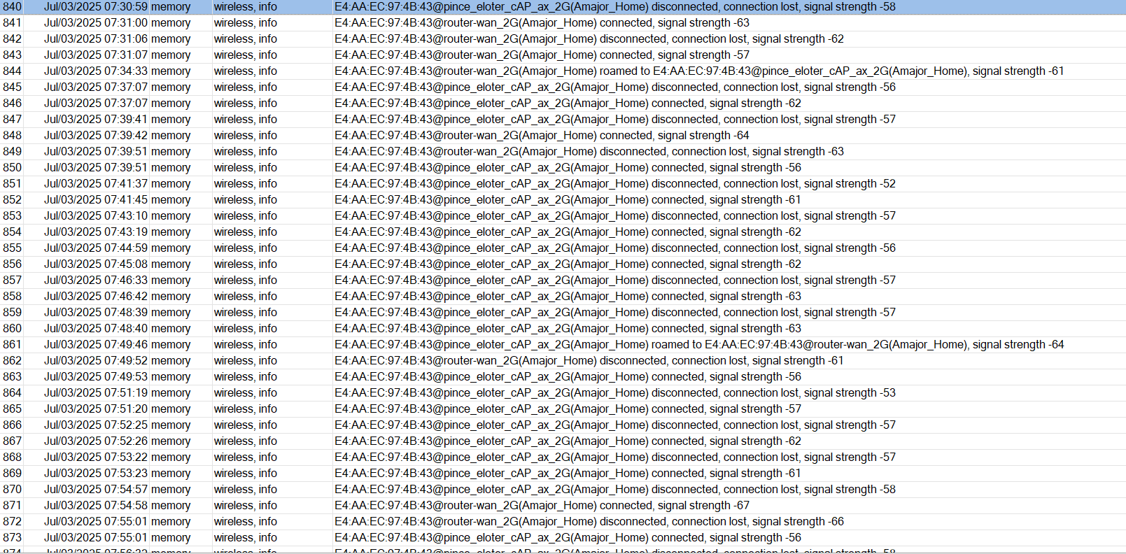

Dear All,
I use ax CAPS and a HeX POE router for CAPSMAN. Main router is a hAP ax3. CAPS are 2 CAP ax and 1 wAP ax. On 5Ghz config FT is enabled, on 2,4Ghz disbled. I have a server inside LAN , available from outside using dst-nat.
My client is an S24 Ultra. If I connect any of the CAPS expect the main router everyting is working fine, but if client roaming back to the main router I receive “no internet available” error. If I try to ping the server I receive “no route to host” error. In this case if I disable the client wifi and enable it again it starts to work or if I wait a few minutes (3-4) also starts to work correctly. I have no idea what should be the problem.
On main router port5 is the WAN port. port1-4 and 2 WIFI ports are in a bridge. port1 connects to the first CAP ax’s port1. CAP ax’s port2 connects to the hEx poe bridge. ON hEX POE all ports are in a bridge and the 2nd CAP ax and wAP ax connects to the hEX POE. on all CAPS all ports are in a bridge. DHCP runs on main router, DNS resolver on the hEX POE.
Last week I did a clear netinstall on all devices, not solved the problem.
Could you be please give me some idea where to start solving the problem. I have absolutly no idea, I tried almost everyting.
Thanks in advance.

SSID is different due to I have many IOT devices and some can drop connection is the SSID is same.
On 2,4Ghz FT is disabled because some of the IOT devices started to play “ping-pong” between CAP ax devices if it was enabled on 2,4GHz, so I disabled.
ax3 interfaces are managed by CAPMAN.
I’m new user , so I have no right to upload config, mayme I can paste here, but it is not short. I exported boot hEX Poe and ax3 config and removed all sensitive data.
Not yet. Earlier I’ve tried to enable , but no change in situation and HW offload on bridge disabled, but no loop in the wired network.
