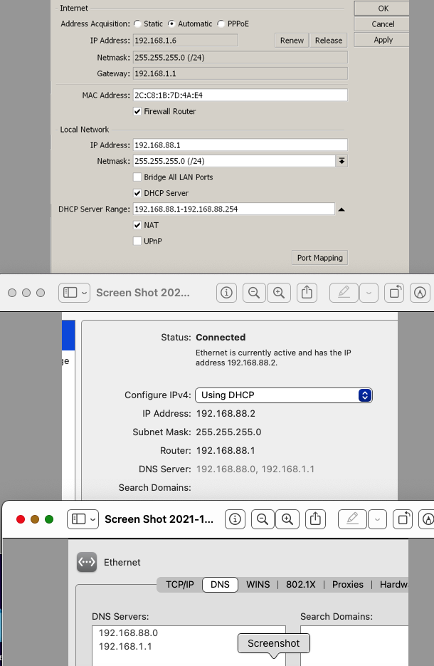

On Quickset my IP Address changed to 192.168.88.0
i am on hAPac2 and I use the QuickSet to add my dual Home AP among other things there. Weird stuff happens here. On Local Network on the right hand side, the IP Address since was 192.168.88.1, Mask 255.255.255.0 (/24), DHCP range 192.168.88.1-192.168.88.254
On my ethernet connection, my DNS entry has this, automatically added by the Network;
192.168.88.0, 192.168.1.1
This .0 above based on what I been told, is not normal, it supposed to be .1, and while this is .0, when I go back to my QuickSet, my IP Address there changed to 192.168.88.0 as well. If I change it to .1, I lose connection from my computer out to the internet and pinging 8.8.8.8 tells me so. My Winbox ping still remains in good terms and gets out normally. Just this thing that changes itself.
Is this normal? or is this an anomally?
Quickset should only be used to decide the router purpose, if used at all, and not for any of the other settings.
Suggest reset to defaults and start fresh
