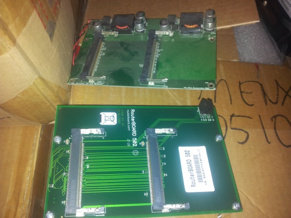

I have not used rb14 to much, but on rb502 You will have a power issue using 12V, and all mini mci cards on the main and expansion card. We have make a proporitary exstention cards, giving the minipci external power, to solve this issue.
pleasu could you draw some scheme what to use and how…to power it external? Thanks
