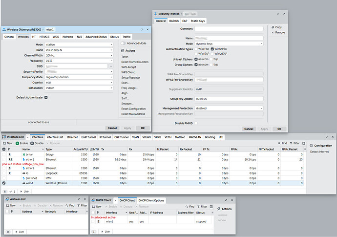

On which mode to run wlan1 for wifi to lan bridge with V7 on a mAP/wAP?
Since router OS >v7 things seem to have changed and shifted.
In a former setup i could simply use the quickset menue for this scenario:
internet (DSL or glass)
random internetrouter (FRITZ!Box or Telekom Speedport Router)
Wifi SSID: "Master-Wifi"
(airgap)
mAP or WAP Wifi set to connect to "Master-Wifi"
dhcp-client listening on wlan1 for ip
lan bridge on ether1 + ether2 in case of the mAP
ether1 (and on the mAP ether2) set on bridge
dhcp-server on bridge
LAN-Client
Is this the new turorial (Scenario #1) on how to set upo this scenario on RouterOS V7 upwards?

Nothing has changed since v7:
All forum users advise against using QuickSet.
How to setup, yes, that's my question.
I can't get it running as i did before and thought it had to do with the version step in RouterOS from 6 to 7.
But there you are wrong.

Walking the long way i will try to set it up on the legacy mAP or/and wAP ac...
Maybe you are able to spot something obvious - i can't unformtunately.
  • wlan1 can connected to Master-Wifi - but which mode should it run in?
    "station pseudobridge", "station bridge", "ap bridge",...
Answer:
  • running it as "bridge" the mAP turns itself to a AP with the same SSID as the Master-Wifi
  • the same for "ap bridge"
  • running as "station" does not connect it to the Master-Wifi AP
  • same for "station-bridge" or "station-pseudobrdige"
  • "station pseudobridge clone" neither working
would "station wds" or "wds slave" make sense?
If you connect to 3rd party router you either use:
station ← Routing
station-pseudobridge ← “Bridging”
Since you have a static frequency set you must check if your Main AP Is acutally broadcasting on this frequency

Hi itimo01,
thanks for your quick reply!
Main AP runs the same frequency, checked!
What setup do you recomend?
Let's say we would like to do station-pseudobridge: what would the steps be to follow?
Do i need to put wlan1, ether1 and ether2 on the same bridge?
Does the bridge aquire the ip from the Master AP? When i tried with the wlan1 interface itself it couldn't.
Yes
You add the DHCP Client on the bridge and the Tik should get an IP. Obviously you first need to check if the connection shows in wireless → Registrations
