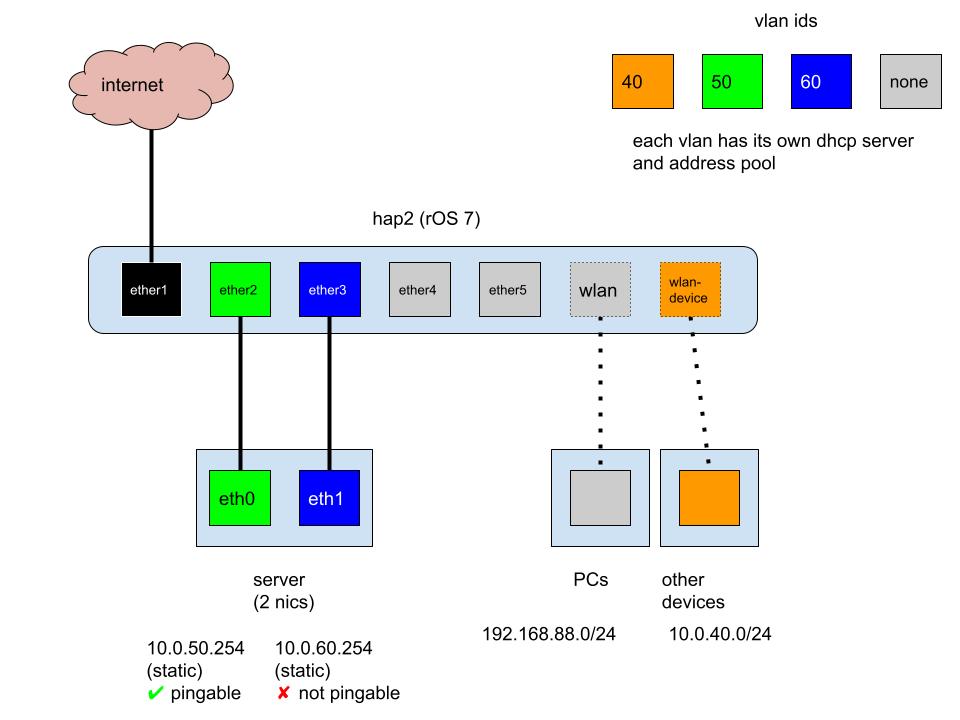

here’s my network:
the problem is that 10.0.60.254 (vlan 60) is not reachable (not pingable) from my pc 192.168.88.x (no vlan). however, 10.0.50.254 (vlan 50) is reachable! i don’t understand why.

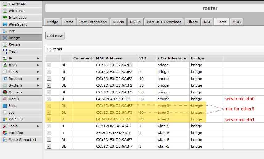

one weird (to me) thing i noticed is that the bridge hosts list shows three hosts on ether3 (vlan 60) while other interfaces have only one or two. i don’t know what this implies.
can someone review my config? i’m basically looking for a code review. my full config is attached

How is the server configured with those teo NICs? Is there a bridge/virtual switch with both NICs configured as members by any chance?
(1) What do you mean NONE? If you start using vlans, then simply make all subnets vlans, clean, apples to apples consistent approach.
(2) Questionable security approach - you have winbox&ssh disabled but you have IP Service WWW enabled. ???
(3) Just disable IPV6 if not using it.
(4) The confusing nomenclature for lists means errors, and yes, you have VLAN in commentary for DNS but use LAN for rules.
Stick to conventions for conventions, and use other names for distinct non OS conventional functions.
( NTP and DNS can go on same udp rule )
(5) What is the point of the above rules anyway if you have a nonsensical matching last rule…
add action=drop chain=input comment=“defconf: drop all not coming from LAN”
in-interface-list=!LAN log-prefix=a
If your last rule is block everything except from the LAN, why bother with allow services to LAN members above that…???
So change last rule to DROP ALL ELSE!!
