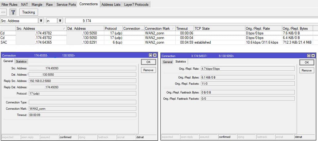

After that, I did a PCC load-balancing using this tutorial in main router.

I did a bandwidth test with “RoofTop Switch”, and also a download test and It works like a charm. Thanks, to ingdaka and anva.
But there is a problem with VoIP remote users. Their softphones can’t reach the VoIP server with IP 192.168.0.2:5060 right after PCC implementation.
I did lots of searches but didn’t find a clear guide or youtube video that helps me figure out the problem.
Also, have a question about how to queue VoIP and other traffic using a queue tree, despite all the packets being marked in the first place for PCC to works.
Please somebody help me, I’m begging you :d. Right now I do not have time for further research and learning, but definitely I will do later.
As a quick fix, you have to exclude the traffic of the VoIP phones from the PCC process, by assigning the same connection-mark (choosing one of the WANs) to all traffic from the VoIP phones by a rule which is placed before the PCC ones and matches e.g. on a src-address-list which contains all the addresses of the phones.
As for translating connection-marks to both routing-marks (to choose a WAN) and packet-marks (to choose a queue), you have to use composite connection-marks as only one can be assigned to a connection at a time. See this earlier post.
Finally, this mini-guide solved my VoIP problem (No VoIP over PCC).
