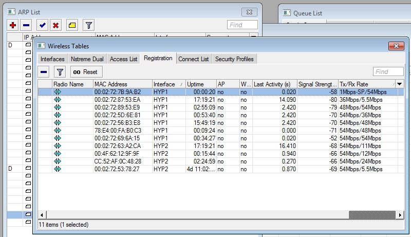

When he is connected, he has this values at my Mikrotik:
Tx/Rx : 1Mbps-SP/54Mbps , Tx/Rx CCQ 20-30percent-> terrible, I know.
Here are the client registration data (marked):

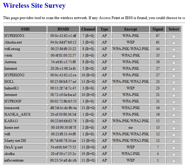

At this moment, when I look at his Router-Client WA2204, I see this (HYPERION1):
When I disconnect him at his AP, everything is OK and the signal of other clients is from -60 to -70.
The strange thing is, that this only happens after sunset or when the weather is bad (snowing, raining…etc.). During the day is everything ok, he even goes 54Mbit/48Mbit and works best in the WLAN, other clients works as well.
