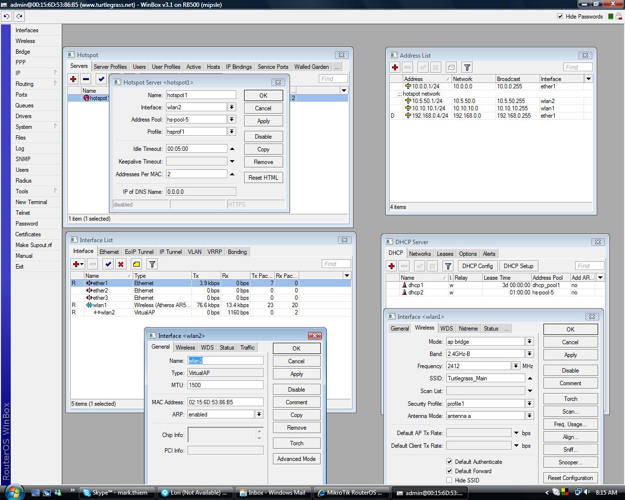

Please see the screen shot of the original hotspot setup. I have removed all attempts at connecting at this point. The new setup is: rb433ah with one XR2 for the omni antenna/client side and one R52h for connecting to the original hotspot system through the built in panel antenna. All the new is housed in the client outdoor enclosure with the omni antenna external. I have removed all attempts on the new system so pretty much default IP addresses, wlan1 is the omni/client side and wlan2 is the r52 to connect with original system. Any other information you need?

Let’s see - you have your original Hotspot depicted above.
First - take the hotspot off of the VAP wlan2 interface in your original unit. You’d want that (wlan2 your ‘new’ Virtual AP) to be just a straight AP Bridge. The IP address is fine. Now set the ssid the same for both of those interfaces, wlan2 (VAP) on the original box and station mode w/the same ssid on the new box in the R52. On your new unit, you need the R52 to have an IP of 10.5.50.2/24 This puts the units in the same IP address block. For the XR2 in the new Hotspot - you’d set it up just like the original except the DHCP IP address block has to be different.
