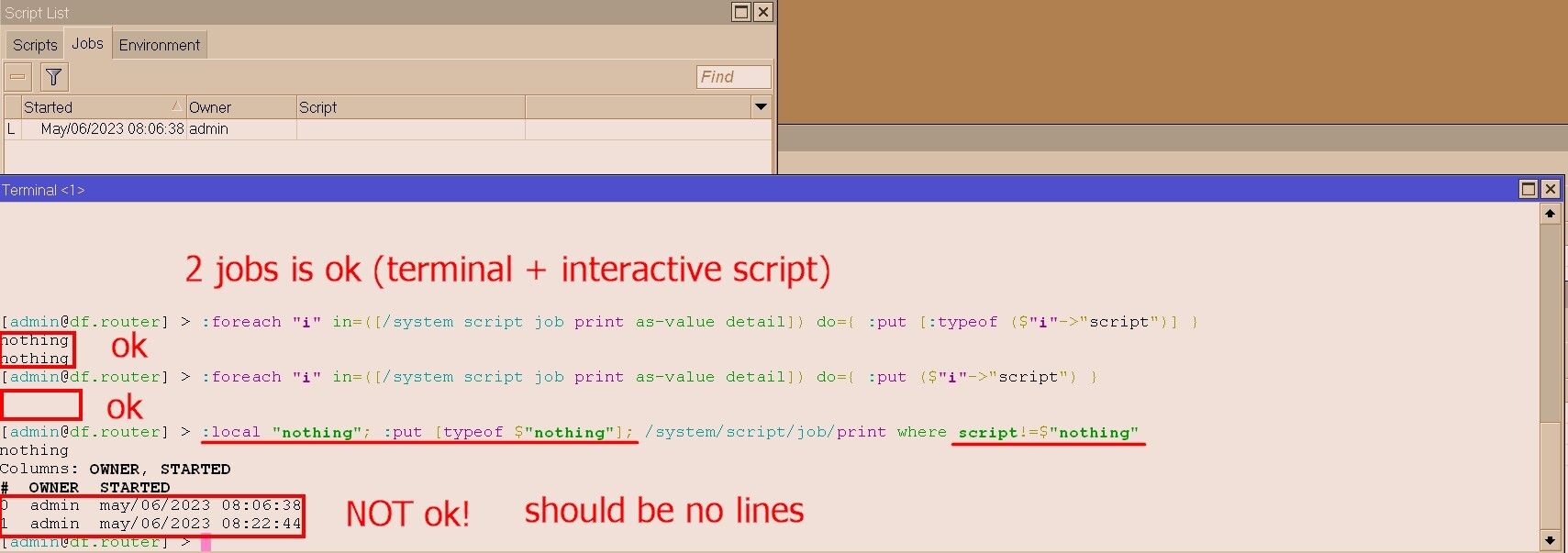

Tested on ROS 7.8:
trying to filter out script jobs with
/system/script/job/print where script!=""
gives unexpected results...
Expected (ok):
[admin@df.router] > :foreach "i" in=([/system script job print as-value detail]) do={ :put [:typeof ($"i"->"script")] }
nothing
nothing
Expected (ok):
[admin@df.router] > :foreach "i" in=([/system script job print as-value detail]) do={ :put ($"i"->"script") }
[admin@df.router] > :local "nothing"; :put [typeof $"nothing"]; /system/script/job/print where script!=$"nothing"
nothing
NOT EXPECTED (!!!):
Columns: OWNER, STARTED
OWNER STARTED
0 admin may/06/2023 08:06:38
1 admin may/06/2023 08:22:44

ok, but how will You explain this:
:put [:typeof []]
nil
If we have launched a simple script with
:delay 60s
Not working (while above script is running):
/system script job print where $"script"=[]
:put [:len [/system script job find where $"script"!=[]]]
0
