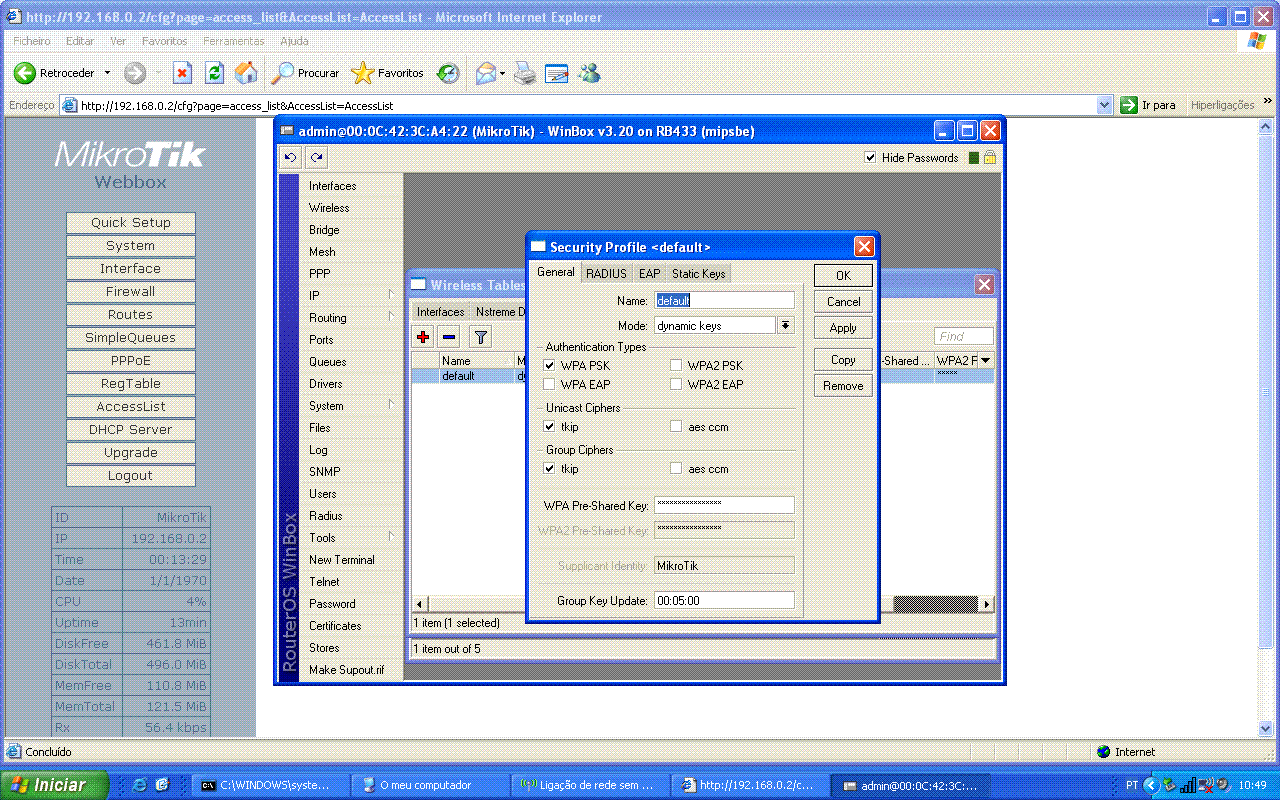

I have enabled wireless card and have set up to ap bridge. But i have set up WPA security with a 16 digit paraphrase and when scan network show me as wep and only 5 digits. How can i solve this? Also do i need to set up the ethernet where i will plug the router? or really just need the ap_brigde and cannot in any of them?
thanks
can you show us your wireless configuration, including the security profile that you made?
you can post code from the command line, or winbox screenshots.

The security part i have solved. I was using browser configuration but on winbox i was able to set up to the security i want and now is well detected.

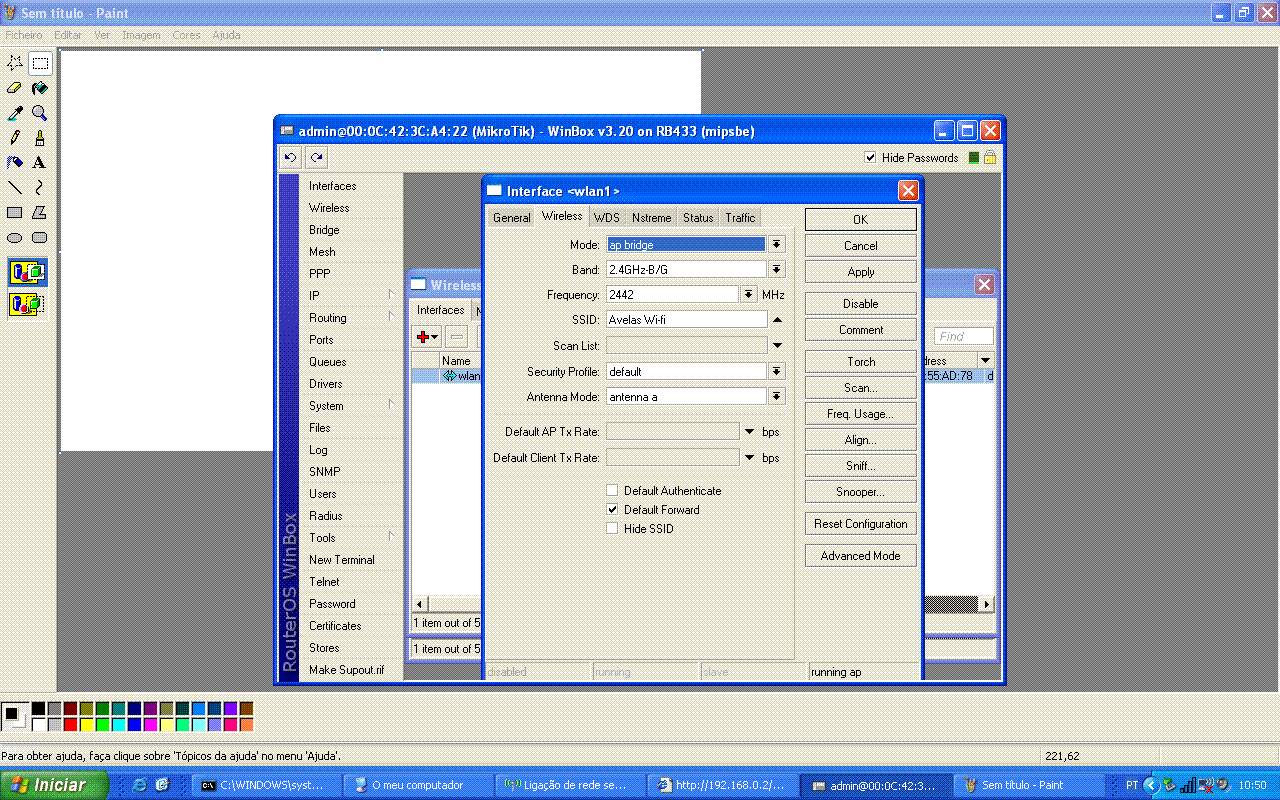

Aatched i send my screenshoots configuration of the ap setup and of secutiry.
don’t use the web-config if you will also use Winbox, they will conflict! Do “/system reset” and reconfigure the router ONLY with winbox.

About the setup of the ap i think i managed to get it work.

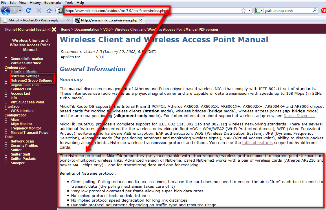

But what is Nstreme field?
Also there must be a bridge from Ether1 to wlan1 in order to use router on ether1? or can be pluged in any port?
And if needed how do i setup a bridge between this?
Once again thanks for your quick answers.
these things are answered in the manual (top of the forum header has links)

now i see. Problem i has viewing the 2.9 version:)
Sorry for that.
And how about the bridge i ve asked? I need to setup?
Thanks once again
exactly the same things are written in 2.9 manual and older, it’s the same text.

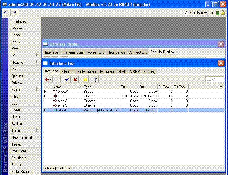

I need to setup bridge between ether1 and wlan right?
But how do i do it? I ve tried to make bridge but after don t know how to select the interface list that would used on bridge.
atached i send screenshoot
tks in advance
interfaces to bridge you need to add in menu Bridge → port
but are you sure you need to bridge? maybe use private IP addresses in your local network, and use a SRC-NAT masquerade rule instead of bridge. Others please comment
