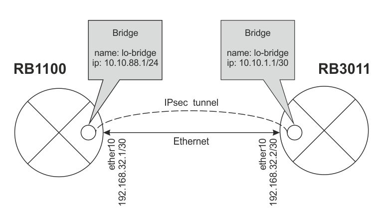

I have RB1100 and RB3011, both runs 6.45.8 firmware. There is IPsec tunnel between them. I can ping RB1100 from RB3011, but can’t ping in other direction.
I created the firewall rule in 3011 to allow traffic from 10.10.88.0/24 and the rule in 1100 to allow traffic from 10.10.1.0/30.

Howether, when I try to ping 10.10.1.1 I see new records in log on 3011:
16:13:58 firewall,info input: in:ether10 out:(unknown 0), src-mac 74:4d:28:e2:cf:8e, proto ICMP (type 8, code 0), 10.10.88.1->10.10.1.1, len 56
16:13:59 firewall,info input: in:ether10 out:(unknown 0), src-mac 74:4d:28:e2:cf:8e, proto ICMP (type 8, code 0), 10.10.88.1->10.10.1.1, len 56
16:14:00 firewall,info input: in:ether10 out:(unknown 0), src-mac 74:4d:28:e2:cf:8e, proto ICMP (type 8, code 0), 10.10.88.1->10.10.1.1, len 56
16:14:01 firewall,info input: in:ether10 out:(unknown 0), src-mac 74:4d:28:e2:cf:8e, proto ICMP (type 8, code 0), 10.10.88.1->10.10.1.1, len 56
16:14:02 firewall,info input: in:ether10 out:(unknown 0), src-mac 74:4d:28:e2:cf:8e, proto ICMP (type 8, code 0), 10.10.88.1->10.10.1.1, len 56
16:14:03 firewall,info input: in:ether10 out:(unknown 0), src-mac 74:4d:28:e2:cf:8e, proto ICMP (type 8, code 0), 10.10.88.1->10.10.1.1, len 56
Please, help me to configure my devices properly.
