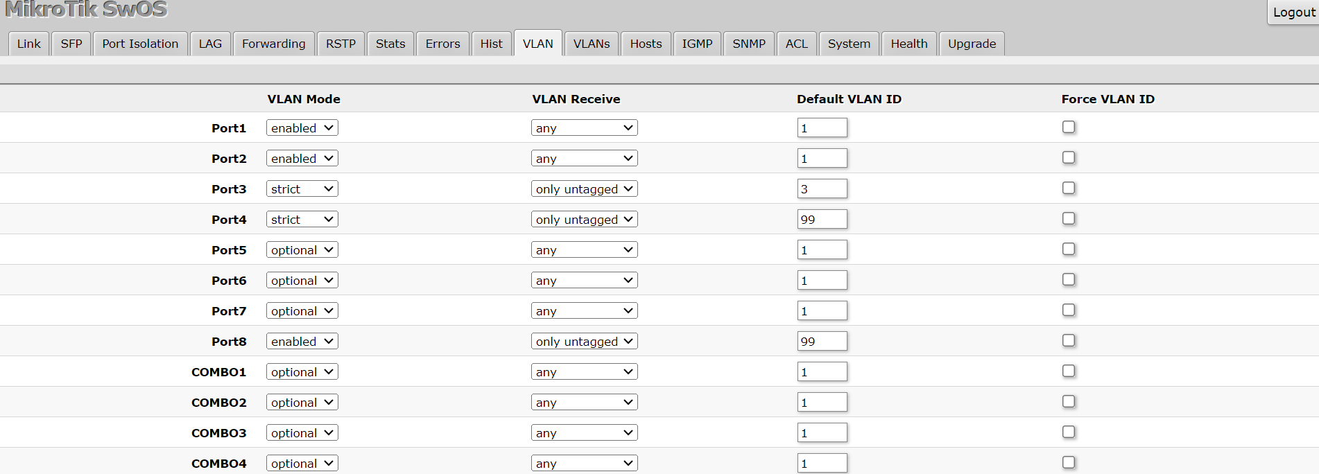

I’m running into a problem while setting up SwitchOS for 3 VLANs, here’s my setup:
  • router: 3 VLANs and their DHCP servers (VLAN 1, 3 and 99) are living on ether2, which is connected to the switch below
  • switch running SwitchOS: ether1 is connected to the router above as a trunk port for VLAN 1,3,99 , ether2 is connected to another switch as trunk port for VLAN 1, 3, 99 (let’s ignore all other interfaces on the switch for now)

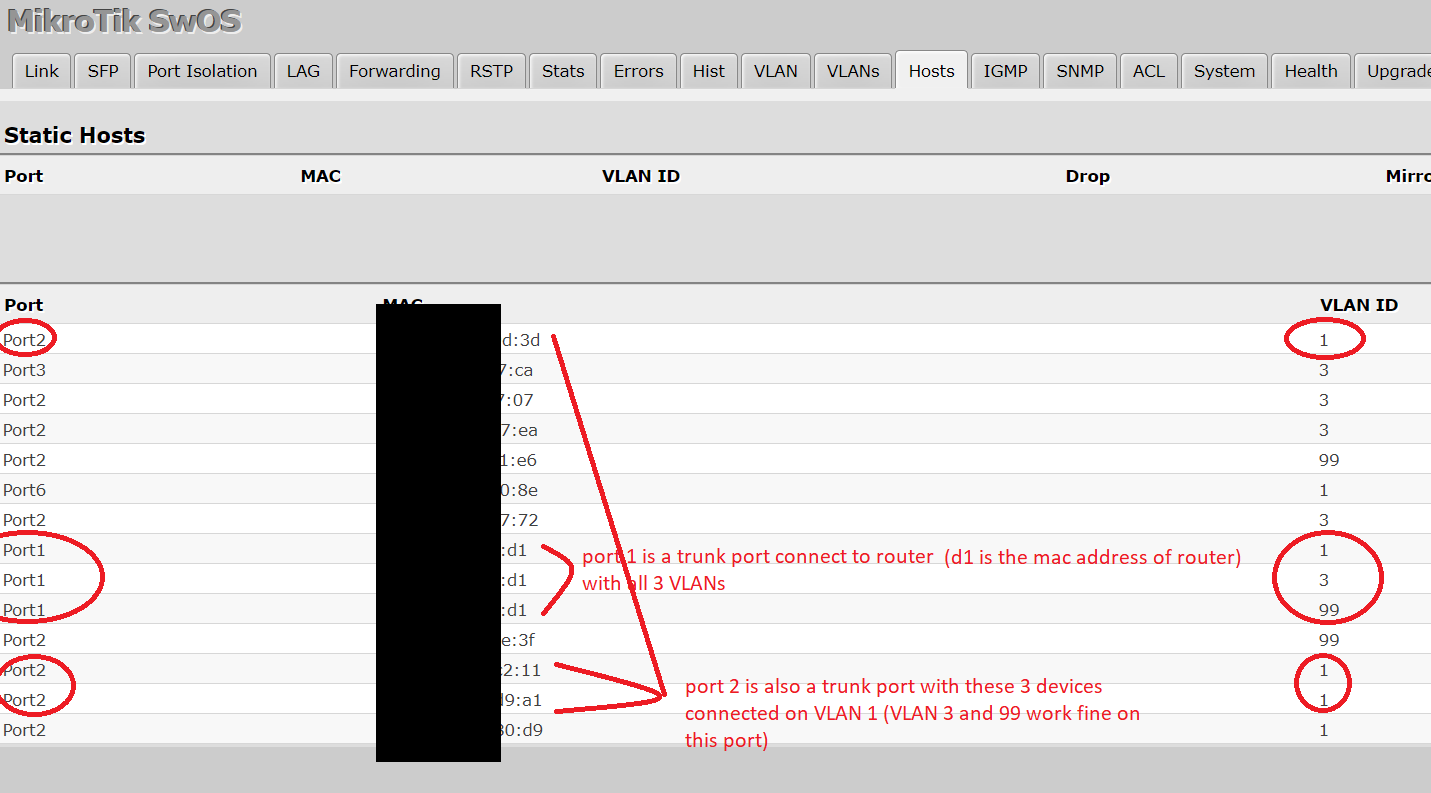

What I found is that devices on VLAN 3 and VLAN 99 connected to ether2 on switch seems to be working fine (getting IP addresses correctly and are pingable).

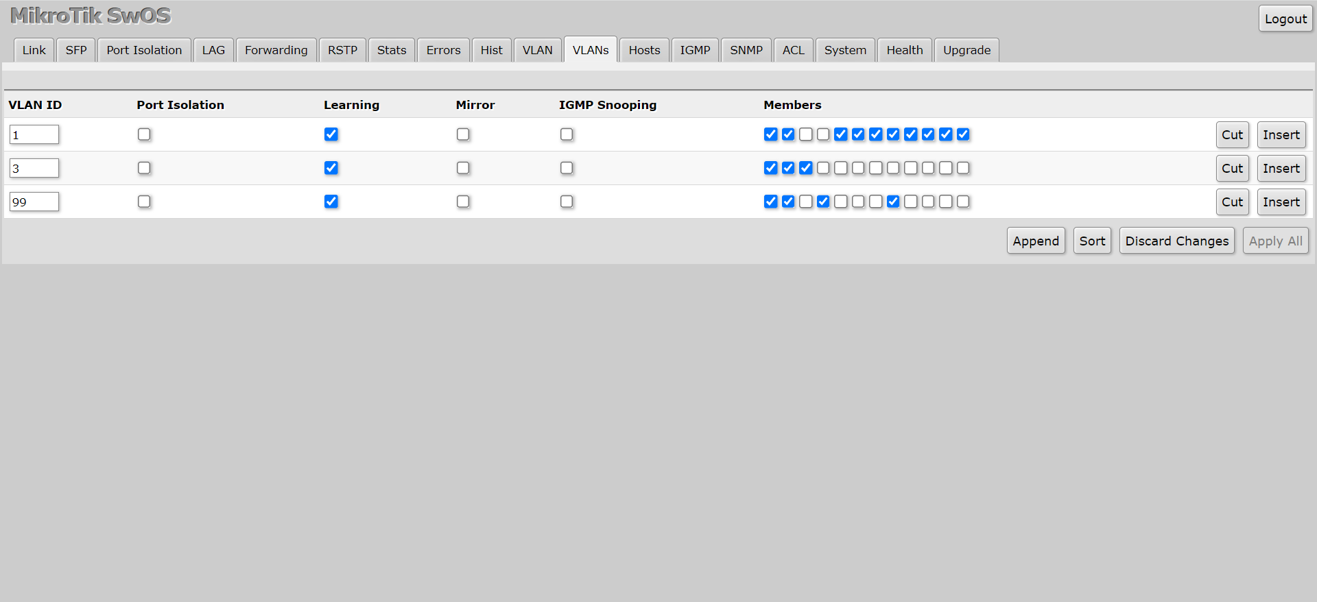

However, there are 3 devices on VLAN 1 connected to ether2 on switch that don’t seem to be getting IP address via the router. If I plug my PC into ether2 on the router (tagged as VLAN 1 in OS), my PC seems to be getting an IP in VLAN1 just fine; plugging in this PC into ether2 on the switch doesn’t work either. So I figured the problem lies in my SwitchOS config which you can find below:
Is VLAN 1 set up as tagged on trunk connection between router and switch? Because it’s set as untagged on switch.
The “problem” with using VID=1 for tagged VLAN is that this VID is very often (also by other vendors) used as default or native VLAN. And then trying to use it in any other way is prone to configuration … deficiencies. So if you don’t have a good reason to stick to VID 1 for tagged traffic, swiitch over to using another VID.
Oh wow, VID=1 is indeed the issue. Once I changed it to a random VID it works…
