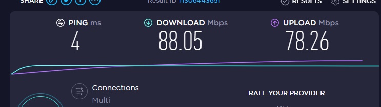

Here is a test on my 100/100 fiber line.
Its limited for one user to max 90Mbps download and 80Mbps upload. (without limit, I get close to 100/100)
