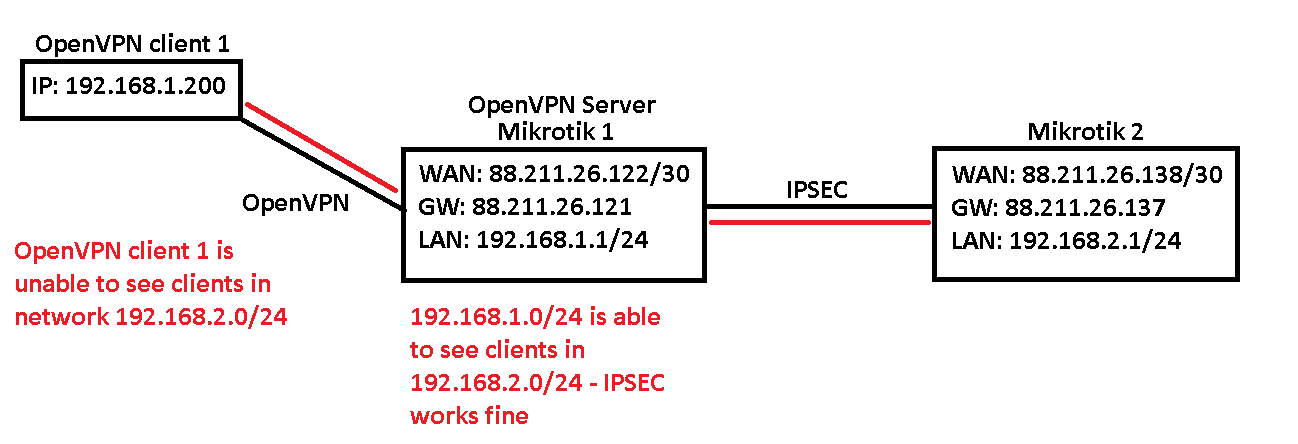

I just bought 2 new Mikrotik routers RB1100AHx4 and did a configuration of local networks as usual and configured IPSEC btw them. IPSEC works fine btw clients in both local networks but then I had to configure an OpenVPN server on Mikrotik 1 and I have to make communicate OpenVPNClient1 to the clients on another site connected via IPSEC. This does not work for me.
Can you please be so kind and take a look on my configuration and point me to some solution?
I am attaching network schema and also configuration from Mikrotik router 1 and also configuration od Mikrotik router 2.
Thanks for support.

The OpenVPN implementation on Mikrotik is unable to push routes to clients (at least in ROS 6.x), have you added a route to 192.168.2.0/24 to OpenVPN’s configuration file on the client?
