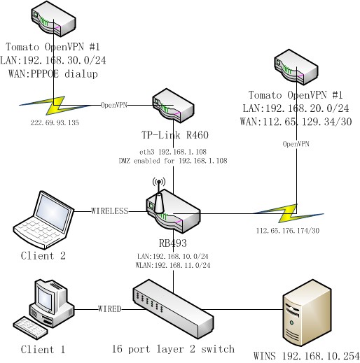

well, here is my network structure
This is also my approach, while I’m currently testing the way start from point to point (windows client)
