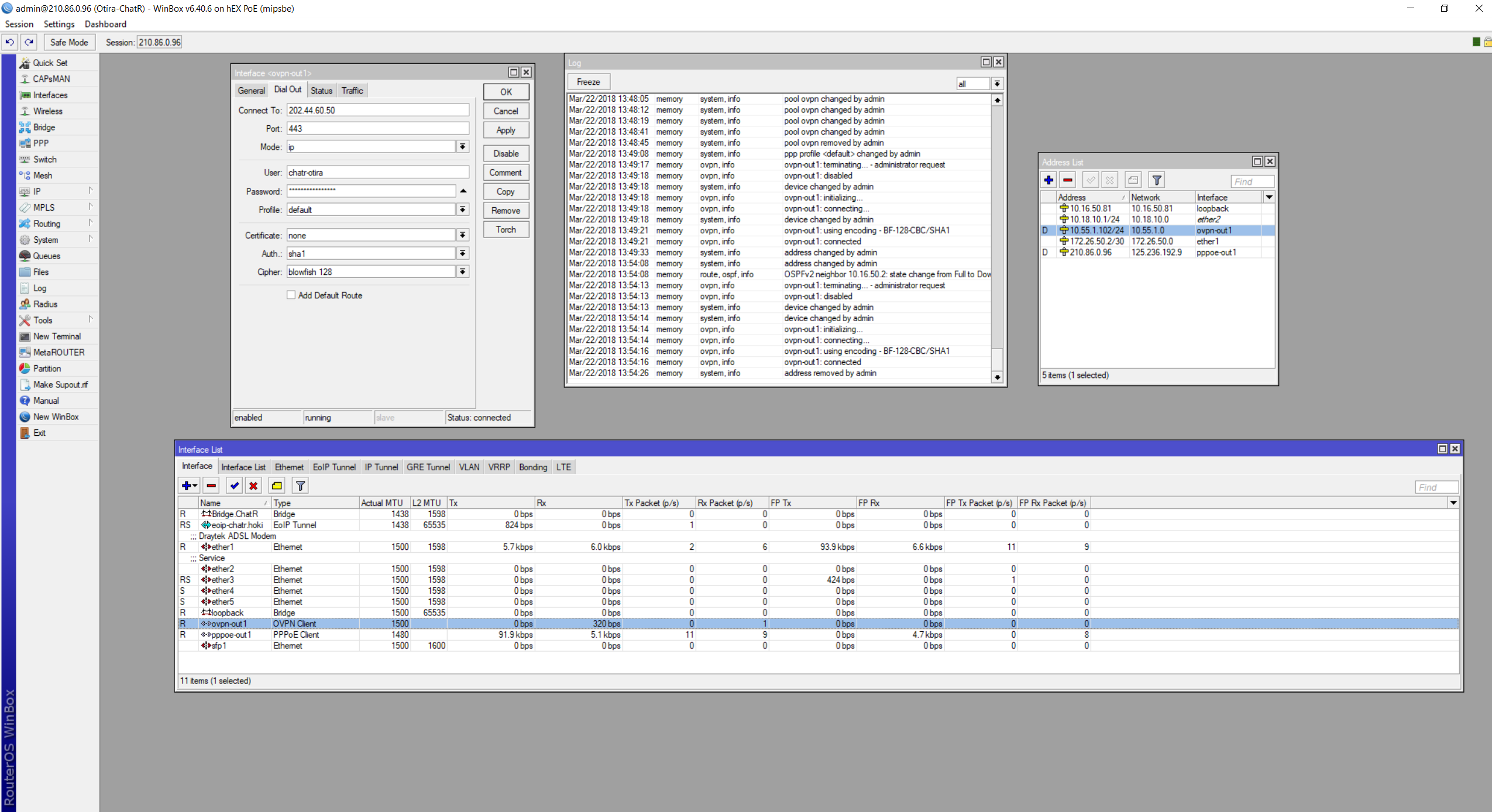

Im having a issue with ovpn as well, when the client connects its getting a /24 address range instead of a /31, it seem to be a issue only on v6.40.3 and above
