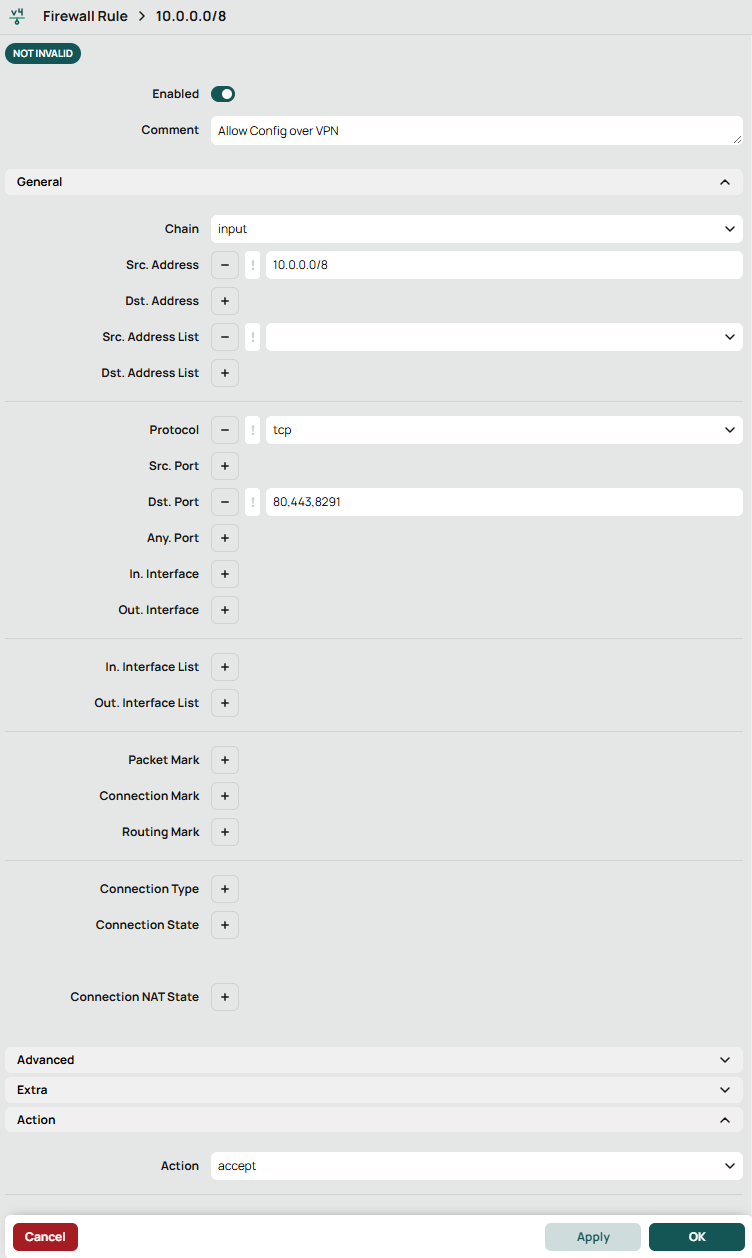

I can’t load the mikrotik web GUI from the server for this router though, which is different from Ubiquiti and OpenWRT routers I’ve worked with in the past. I assume some firewall or other setting preventing that, I’ll work on that next.
I think the VPN part is fixed though.
I glad to hear you’ve got your VPN working.
You will need to adjust his line:
/tool mac-server mac-winbox set allowed-interface-list=LAN
to allow the VPN connection to access the web GUI. Alternatively you can add the VPN to the LAN list.
I’m not well versed with Mikrotik CLI at all. Also the rule I added was more crude than what you are referring to but this worked.
