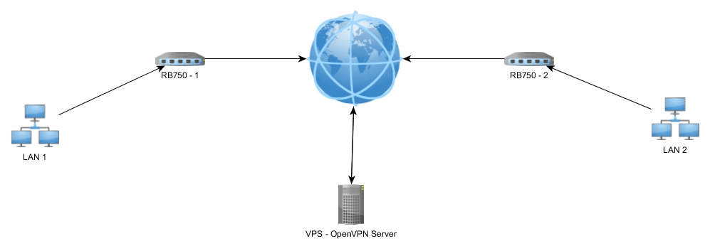

Well, I have in mind a configuration for access my two factory locations, each one has a RB750, but I don’t have any Static IP address to use any one as VPN Server.
So I have a VPS with debian 8 running OpenVPN Server, and it uses certificates for each client, and I use the ta.key, every client I connect is running fine, even iPhone, and some smartphones.
My question, how can I configure the OVPN Client in my RB’s so they can use the ta.key files to connect to servers?
and How I need to do all the configuration, because I tried to make the connections with and without the ta.key, but I cannot manage to establish contact with the server, at least the server don’t log any activity from the RB’s, is there any special route I need to add? or just the interface with all the parameters?
I hopen it is understandable.
Thanks in advance for the help.
