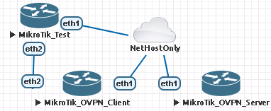

I have the following configuration:

192.168.101.230 MikroTik_Test
192.168.101.240 MikroTik_Client (OpenVPN assigned from MikroTik_Server)
192.168.101.251 MikroTik_Client
192.168.101.252 MikroTik_Client
192.168.101.253 MikroTik_Server
192.168.101.254 MikroTik_Client
MikroTik_OVPN_Client and MikroTik_OVPN_Server are connected together through OpenVPN (ethernet mode) by external network (192.168.184.0/24, NetHostOnly from picture above). VLANs are used internally to separate networks within device.
All IPs in those devices which belnongs 192.168.101.0/24 network should be accessible from any device …
but:
ICMP(ping) from MikroTik_Test to 192.168.101.240 or 192.168.101.252 FAILS while 192.168.101.251 and 192.168.101.254 are OK (very strange cause if I close OpenVPN connection between Client and Server 192.168.101.252 becomes accessible from Test)
ICMP(ping) from MikroTik_Server to 192.168.101.240 or 192.168.101.251 or 192.168.101.254 FAILS while 192.168.101.252 is OK (at same device where 192.168.101.251 is inaccessible !!!)
Sometimes after restarting the devices, communication problems occur randomly to addresses 192.168.101.251, 192.168.101.252, 192.168.101.254 (all in Client) when accessed from Test or Server. They are never accessible in same time.
I tested it on newest firmware (7.13.2 CHR), but problem occurs on previous versions (including RoS 6) and physical devices.
What is the problem ?
