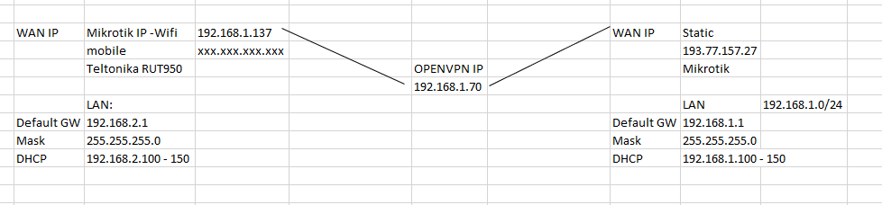

To start with, please provide a diagram with how your network(s?) is/are setup.
What IP subnets are you using on each network?
You are connecting DHCP and then making an OpenVPN connection, to the same network?
You can’t ping from a computer, to an IP on the same network? Or a different network? Different network but same IP subnet?

i’m using normal 192.168.1.0/24 for mikrotik LAN, on teltonika it has 192.168.2.0/24 LAN.
if i try using mobile data on teltonika and connect via mikrotik WAN (i have static IP) it does the same as if i connect teltonika to Wifi on mikrotik with DHCP. (i have noticed the same thing if i have my PC connected to mikrotik via ethernet cable and connect openVPN or L2TP)
