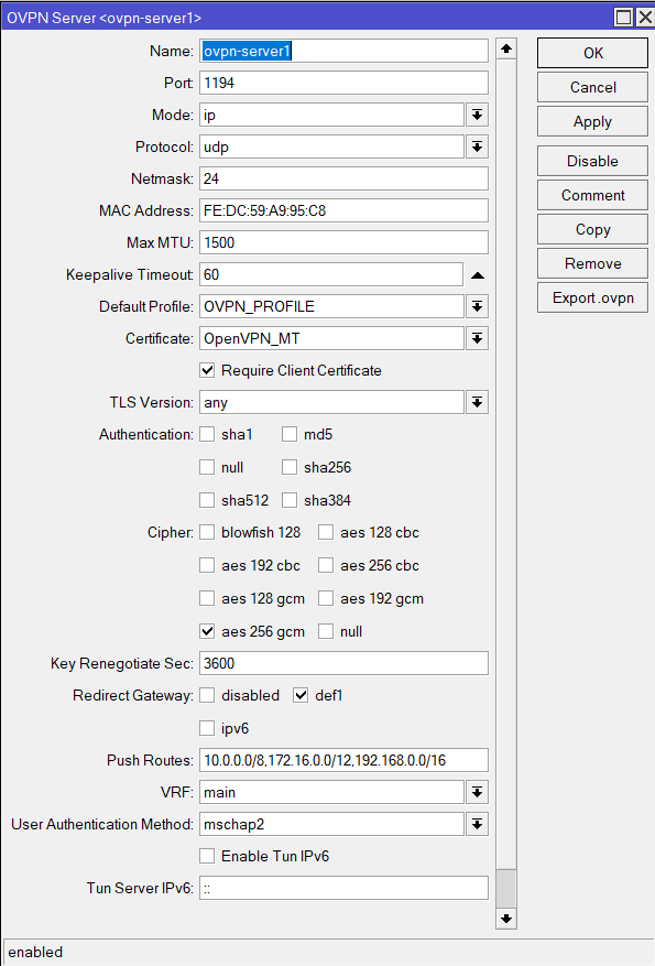

OpenVPN only reaching other OpenVPN connected clients
The connection to the OpenVPN server running on the MikroTik is working fine for months on iPhone, Android and Apple Mac. Now i reinstalled Windows 11 and a connection is established, routes are learned though unable to reach any internal servers. When using the same profile on iPhone, Android and Mac then all is good.
So we can rule out routing issues on the server side. Weird thing is that i can reach other clients connected to the OpenVPN server and ping them. Hence data is passed and received.
I’m seeking some advice on how to troubleshoot this issue as it seems to be a specific Windows machine / os related issue. Routing tables are checked and correct.
When using a windows SSTP VPN connection it connects fine and data is passed, though SSTP is not using UDP and hence notorious slow when using high latency internet connections.
I ruled out the openvpn client install as i have a second profile to a Unifi device and that works just fine, though this is also a TCP based solution.
Tested already without Windows Firewall enabled;
Tested with ‘redirect-gateway def1’ to pass all traffic;
Tested with my iPhone on the same WiFi and that worked fine - can access internal resources;
I can ping from the windows machine with the openvpn connected to the iPhone vpn address without issues;
Who might have a suggestion where to look?
On the OpenVPN server do you push the correct routes with the correct mask ?
And on the Windows 11, what internal ip do you have and what mask ?
Also suggest you to do a drawing with your all equipment and there ip's, for more problems solving.

As our network is 192.168.0.0/23 this should not pose an issue. As the iPhone is connected to the same hotel wifi and is able to connect to internal resources, we can rule out routing and metric issues.
why on the windows machine we can reach the vpn ip of the iPhone is strange though shows traffic somehow gets passed over the vpn.
We push: 10.0.0.0/8,172.16.0.0/12,192.168.0.0/16
Though that is not the issue. We have been running without routes for a long time and just push all through using the ‘redirect-gateway def1’ in the profile.
Setup is as following:
Windows 11 → Internet (hotel / 5g tethering) → KPN 4Gbps fiber (routed subnet) → Mikrotik CCR2116-12G-4S+ → internal network (192.168.0.0/23)
internally there are 2 more break outs for redundancy, 1 Ziggo Cable modem 1Gbps/100Mbps, 5g modem dial-out. In the network there is a Cisco ASA for Ziggo and a Unifi Pro connected to the mikrotik on a different public IP. All of this is just FYI as they are not really part of the communication flows. Just merely to sketch that networking is something we know. Cisco Any Connect is available on the ASA with a different private range, unifi has also an openvpn server with a different private range. So we can pick and choose depending on what is needed. Remainder of the connections are all IPSEC towards our customers.
As the iPhone uses the same profile and can reach internal hosts, and we have been using this for months without issues on non-windows machines, we can rule out anything routing on the network side. Otherwise the iPhone would not be able to reach internal resources as well.
And that is what makes this strange.
Forgot to mention we also used an older openvpn client but that made no difference.
