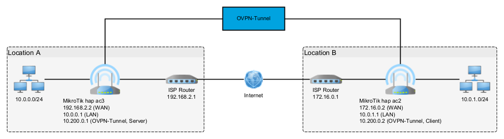

The network:
Both MikroTik devices are on RouterOS v7.1.5
The configuration:
  • Location A:

  • Location B:

The Problem:
When I initiate the connection everything is working flawlessly. The client is connecting and devices from within the local networks can reach each other. However, if for some reason the ISP router at location B disconnects from the internet (it does for instance reboot once a day or if I simple remove the ethernet cable) the VPN tunnel obviously gets interrupted. The “R” at the OpenVPN client vanishes. However, at location A, the server does not seem to recognize that the client has disconnected (the “R” for the server binding remains there). And once internet connectivity is reestablished the client does not connect (status "Link established). When I manually disable the server binding at location A for a few seconds and re-enable it again, everything is working again, so I assume this has to do with the server, not the client.
