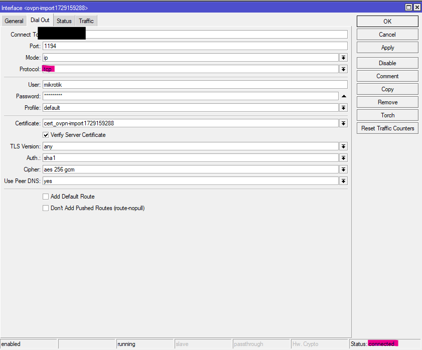

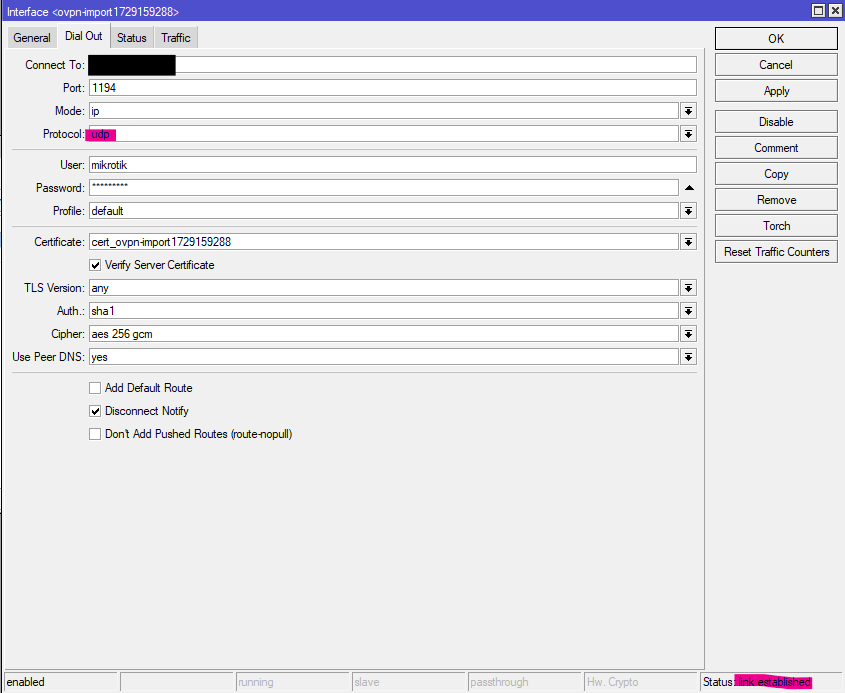

Running Opnsense as VPN-server and Mikrotik as a client I get the following issues.
If I have a OpenVPN running on TCP it works but as soon as I set it as UDP I get “Connection established” but it doesn’t connect.
If I reboot opnsense it connects, sometimes but not always. And if I disable the client in Mikrotik and enable it again it never connects again.
On the server side I get this error: Unroutable control packet received from [AF_INET6]::ffff:IP-removed:48055 (via ::ffff:IP-removed%em0) (si=3 op=P_CONTROL_V1)

I have attached pictures from Winbox :slight_smile:

It actually do work, BUT!
If I set it up in opnsense as before, setup everything in Mikrotik it will connect after about 3 minutes byt itself.
If I then disable the VPN in the Mikrotik or on opnsense and enable the tunnel again it will connect again after about 3 minutes.
Mikrotik only says “Link established” during this wait.
Meanwhile the log in opnsense logs: TLS Error: Unroutable control packet received from… about once a second for 3 minutes and then everything connects and works properly.
If it disconnects for any reason it will start over with TLS Error: Unroutable control packet received from for about 3 minutes and then everything connects and works again.
I also can’t set “Keep alive interval” and “Keep alive timeout” in opnsense. That will break the tunnel and then we’re back at waiting 3 minutes.
