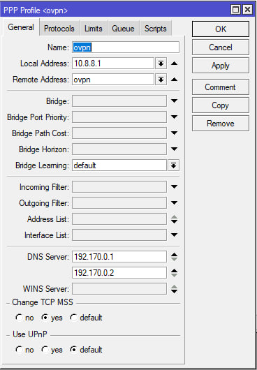

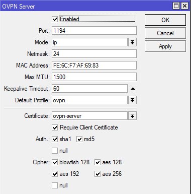

Hello everyone, I can’t access the local segment. There is a local network 192.170.0.0/21 and OPENVPN 10.8.8.0/24, when connecting from a remote network there should be access to 192.170.0.0/21. I assume that the problem is in the routes, but I seem to be trying to register them in statics, there are no results. Below is the system configuration, I would be very glad if you could help solve the issue. Thank you.

You probably should setup “Push Routes” on the Server to get the route send to your clients, see https://help.mikrotik.com/docs/display/ROS/OpenVPN#OpenVPN-ClientConfig.
This will only work with ROS 7.14 or newer on server side, the line is cut off on your screenshot, in Terminal you could use this:
/interface ovpn-server server set push-routes=“192.170.0.0 255.255.248.0 10.8.8.1 9”
