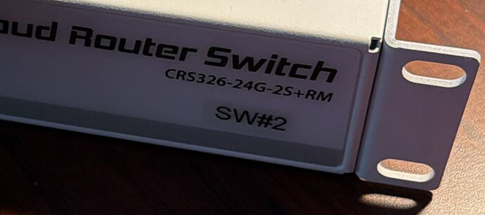

Ordered a CRS326-24G-2S+RM in a third party shop, looked like original packaging, but had a strange label "SW#2" on the front and does not seem to work even after reset
Confusing. After ordering the named part from a german shop, I am suspecting that they sold a used (possibly bricked) part as new hardware. It came in what looked like original packaging.
It does not seem to boot correctly, as of now we are not even able to access the webinterface. Tried to reset the device two times, without any success.
What do you think? Or is there someone reading in the community who returned a faulty device with the label "SW#2" recently?
This is very likely going back, which is a pity due to the time wasted on return and resend of another unit.

Got it working, it seems to have had a strange preconfiguration running. Netinstall would have worked, but we figured that a little tcpdump and arp-entry or quickly running a DHCP server, was sufficient to access the box.
It was now fully reset and updated.
Yea well, it is a bit shady. I dont want to disclose the shop here, but it is a normal popular shop for networking equipment. Official distributor, idk.
That's clearly a returned item with that SW#2 label - that's exactly where I put my labels on those switches...
Pretty dicey that they are selling that as new when it's clearly been used
