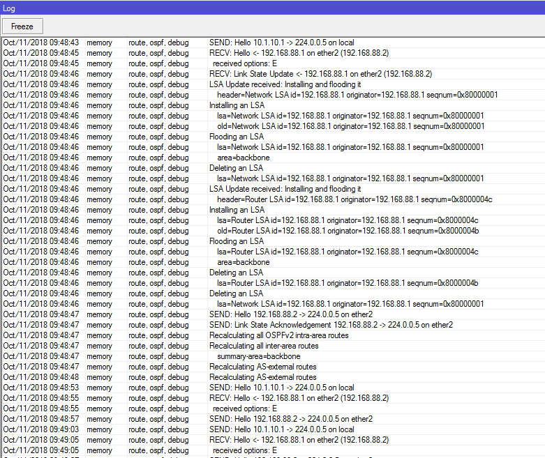

Hi, on one of my routers I am running into issues with OSPF, every ±30min the IP->Routes table drops all OSPF routes but still appears in LSA. I have to manually disable all networks in Routing->OSPF->Networks and then enable them to pick up the routes again. I have the same configuration on all of my other routers by using a loopback interface router-id as the IP on that interface. This does not happen on my other routers and I have tried resetting the entire router and started from scratch with no luck.
PS. I have tried sing NMBA Neighbours and the same thing happens.
The router having issues is backhauled via an nv2 link with -50dBm signal and 100% CCQ and both router neighbours are running RouterOS v6.42.9 bugfix
I see a few topics on this and none of them have been solved!
OSPF Debug:
/export hide-sensitive output:

But if you check the debug log I posted, state has not changed in the log and usually if it does change it logs it. The screenshot is when the routes get dropped.
