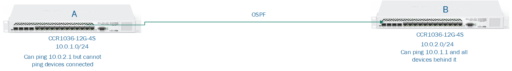

We have 2 CCR1036 with OSPF and a handful of subnets that are advertising to each other. Out of the blue starting about 2 days ago we lost access to some subnets on the other side of the network (aka: the other CCR1036) But if I got behind the CCR1036 that we were not able to access I could route to all subnets fine.

Yes, I looked at the routing tables and everything was there in black and white. I will draw up a diagram with visio and upload to better visualize.
Router A could ping Router B but could not ping devices behind it.
Router B could ping Router A and could ping all devices behind it.
No firewalls were in place. I checked routing tables and all was working.
More to add about OSPF connectivity between both routers…(both are connected by a /30 network)
Router A could ping it’s own /30 address but could not ping the Router B’s /30 address
However…
Router B could ping both /30 addresses.
Very weird situation I was in. But a reboot on Router A solved the issue/bug I was experiencing.
