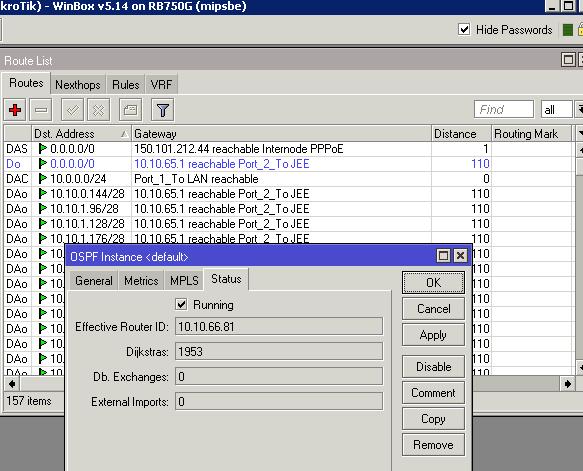

My main question is why and what is up with blue colored text in Winbox against some of my entries. ???
Below is my ospf code and screen shots.
I am able to ping routers down the ospf path from the mikrotik terminal interface with no problem.

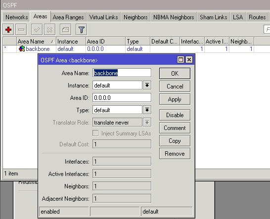

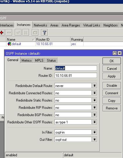

I also note that the instace and area’s code seems to have default entries that I cannot delete(can modify, so i did ! ) not sure about that.
Can someone give some pointers that I have missed ??

Blue means “Default”
Thanks for that simple answer.
I’ll assume I can carry on without issue ?
or is there a better way for me to add entries other than using `defaults’ for coding up ospf ?
Regards.
It doesn’t matter, you can edit default or add new entries.
