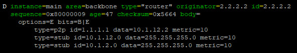

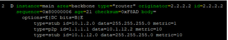

Hi, I had the same problem. After some tinkering with Cisco and ROS 6.46 I was able to discover the following:
  1. In Cisco and RouterOS 6.46, everything works, the route to the network announced in NSSA appears on R1. LSA Type 1 are as follows:
    RouterOS 6.46
    Cisco
    As you can see, there are E and B bits that tell us that this router (R2) is an ABR and an ASBR
  2. The route is not displayed in RouterOS 7.11.2, but the LSA type 5 is available in the database
    We also see that in LSA type 1, the R2 only sets the B bit, which tells us that this is just an ABR
    However, if we configure R2 to perform radio distribution, for example RIP, it will additionally mark itself as an ASBR, and R1 will place the route from NSSA in the routing table
