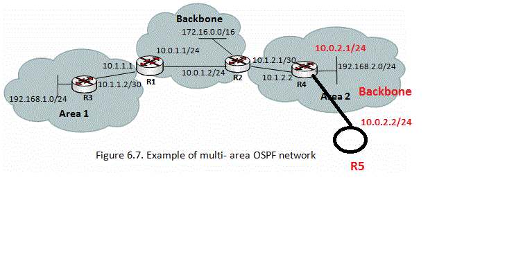

where is my problem?
i’m following e.g. from Mikrotik wiki. everything working good. If i like to connect another router on R4 by OSPF backbone, if im writhing address on ospf network all the route doing down. Why??
see picture
You can only have one backbone area, and except for virtual links (which OSPF designers strongly discourage using them except where absolutely necessary), the backbone area must be contiguous.
I like to explain it to people by saying that imagine your OSPF domain’s topology like a sunflower. The black center is the backbone area, and all other areas are like the petals connected to it.
To get from one area to the other, you first go up to the backbone, then over to the other area border, and then down into that area.
So in your diagram, R4 would become another ABR (meaning that it should be on the “edge” of the area 2, and R5 should also be connected to routers R1 and/or R2 somehow - and all links from R4 → R5 → R1/2 should be part of area 0.
Otherwise, you should make 10.0.2.0/24 be another network in area 2.
