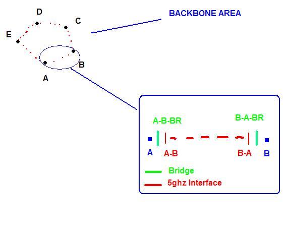

Okay i’ll try to present it, below you have a quick draw of my backbone:
Now here’s the config for A router:

Those configs looks pretty the same for B-C connection C-D etc. (of course the ip adresses are different but the whole idea stays the same)
Hope now you can understand it. There’s another problem that i have met, recently i got ip pool from ripe, and i assign public ips by pppoe (for egz. 88.134.25.100) to some of my end users, i also added an public ips to the routers(88.134.25.50-55), and what i see when i do a traceroute from internet to 88.134.25.100 that the route is traceable only to my gateway, then when it goes say through routers A and B (it shows priavate adresses (for egz. 10.11.0.2) or just “*”). I’m sure there’s something trivial in how i do configuration of ospf or interfaces. I would really appreciate your help

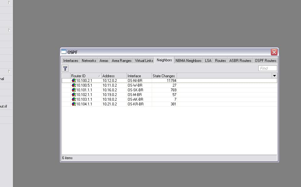

Please look below, and see this is not something that, i’ve made up, and this is not something that can be acceptable.
Cheers
Michal

Hi Michael,
I don’t understand why you’re using bridges?
Makes things complicated and more likely to run into a bug :wink:).
Or do I miss the point?
Stefan
