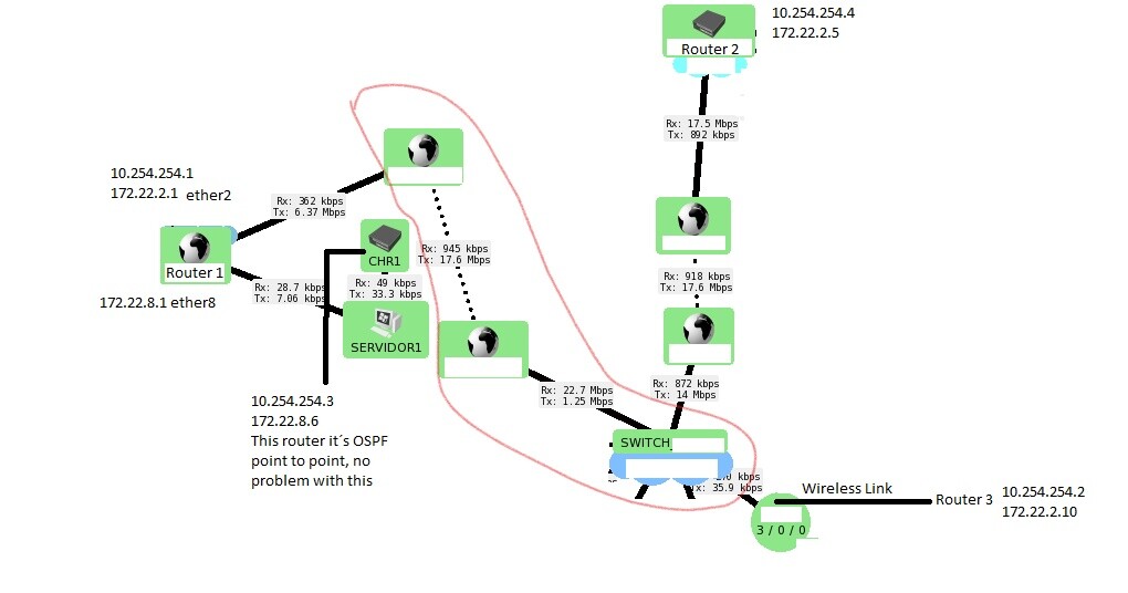

Perhaps a drawing showing the layout of your network might help a lot here.
I attach all the information, if you need more information or anything let me know.

What is the difference between a solid and dotted black lines on your topology?

  • Solid it´s wired and dotted was wireless.

I assume the devices I’ve circled are yours?
When OSPF goes down, can you check the logs on these to see if anything happened at the same time?
