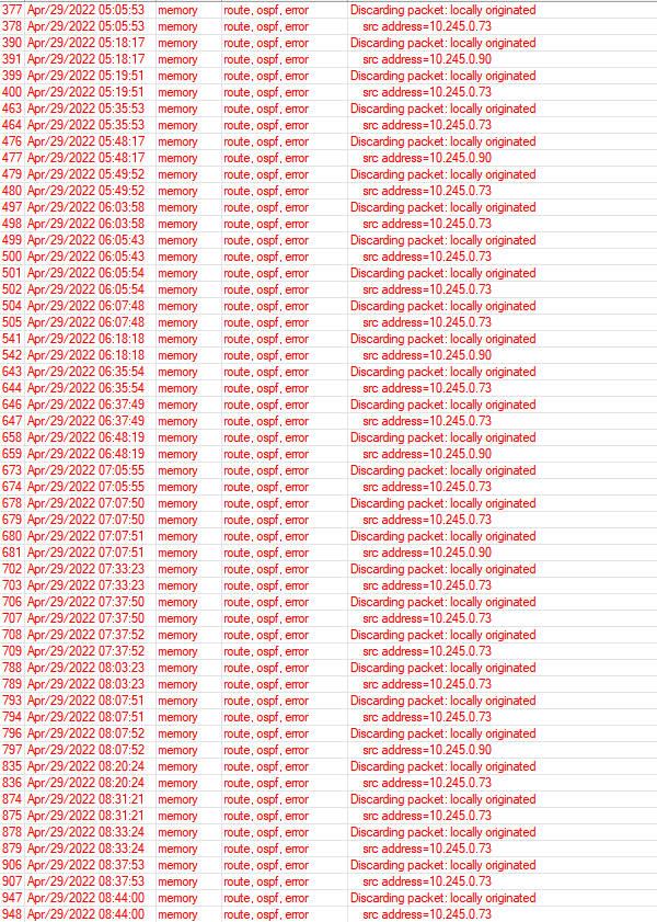

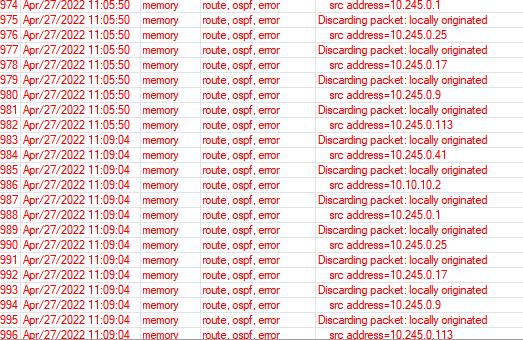

This is the errors I’m receiving in almost all MKTs
