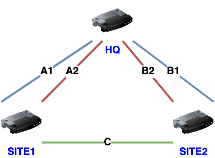

I have a scenario I have been testing with what appears to be inconsistent results, and I was wondering if anyone could help me understand why.
Please see the attached diagram.
  • HQ is the company head quarters (hub site), and has dual connections to SITE1 and SITE2 via GRE tunnels (/30) (in IPSEC) over separate internet connections.
  • SITE1 and SITE2 also have a single connection, and also a GRE tunnel between them.
  • OSPF costs are configured as such that the BLUE links are primary, RED links are secondary
What I observed when running a continual ping from HQ to SITE1:-
  • Normally traffic goes over A1
  • When A1 between HQ and SITE1 goes down, A2 takes over and traffic resumes after approx 30-40 seconds (dead-interval?)
However, if A2 is already down it would instantly go via A3 (via primary link to SITE2), and then C - hardly any disruption to ping.
So I do not understand why it takes longer to fail onto A2 (a direct link), than traversing another site (link A3, then link C).
All routers are RouterBOARD 3011UiAS running 6.49.10
