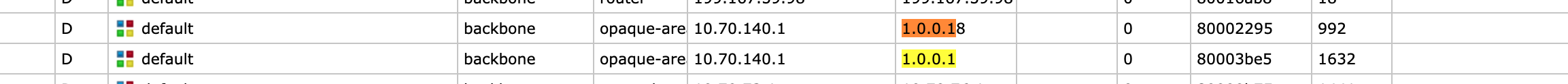

and here are the routes from the LSA table on the SXT - I am looking to filter out these two entries.
[admin@nycmesh-177-sxtsq] > /routing/ospf/lsa/print  where type=opaque-area
Flags: S - self-originated, F - flushing, W - wraparound; D - dynamic
 3  D instance=default area=backbone type="opaque-area" originator=10.70.140.1 id=1.0.0.1 sequence=0x80003D02 age=1669 checksum=0x7BB9 body=address: 10.70.140.1
 4  D instance=default area=backbone type="opaque-area" originator=10.70.140.1 id=1.0.0.18 sequence=0x800023B2 age=1269 checksum=0xC9AA body=corrupted body
You can filter only external LSAs. What device is generating those opaque LSAs with corrupt body?
its a ubiquiti edgemax device. these lsadb entries dont turn into routes on the mikrotik devices (as expected), however, bird still gets these LSADB entries which I want to remove.

Firstly, I am using Bird 1.6.3,. not 2.x. Secondly, I have tried to do that but failed to get the filter correct. Do you have any suggestions? These two opaque routes only exist in the LSADB - they dont show up in routes in BIRD or the mikrotik devices. From a post above, you can see the LSA type is coming in as 0000 (Bird doesnt recognize it)

yes it is a weird issue. I fixed this by logging into the Ubiquiti Edge Router device, upgrading it and making sure opaque lsa routes are off.
