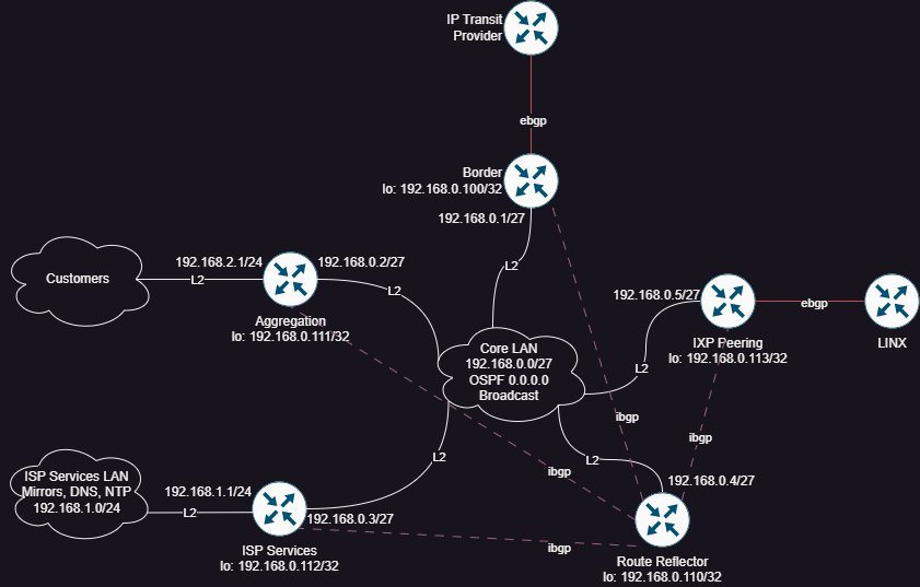

The problem at the moment is that I am still seeing the subnets I want to exclude placed in OSPF AND ibgp, and because ibgp has higher path cost ospf is preferred. Anyway they should not be there as per best practice.
Below is my network:
Objective:
1: INCLUDE the direct connected loopback address in the ospf
2: INCLUDE the direct connected 192.168.0.0/27 Core LAN addresses in ospf
3: EXCLUDE the direct connected 192.168.2.0/24 and 192.168.1.0/24 networks from OSPF so that I can advertise them instead to IBGP

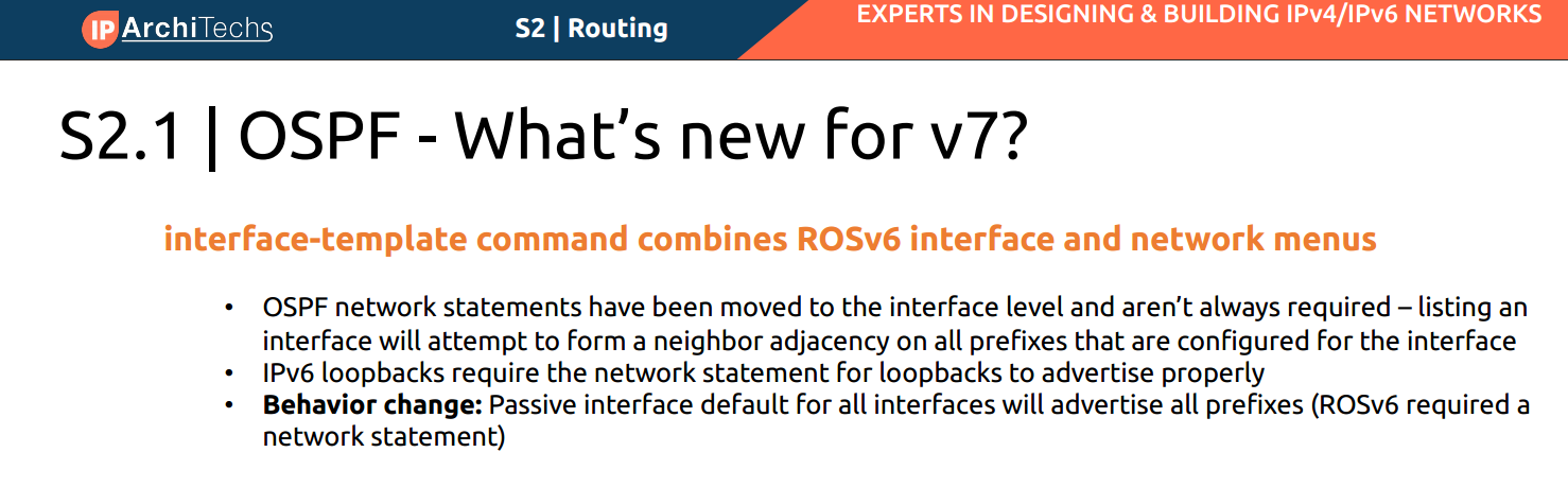

I have found this:
https://iparchitechs.com/presentations/2022-RouterOS7-Layer-3-Deep-Dive/RouterOS-7-Layer-3-Deep-Dive.pdf
Says network statements have moved to interface level.
Let me explore.
I think I have solved it.
adding the lo interface to the interface template and then adding the prefixes to the Networks field of the Interface template, and then removing redistribute connected from the instance is now showing what I expected.
