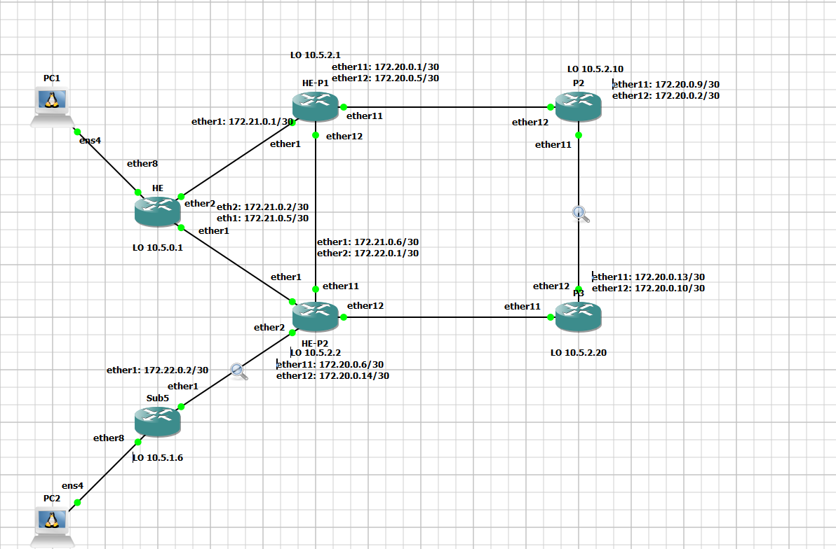

After some further troubleshooting and some more lab work, I was able to determine the cause of my issue. I run 3 separate Loopback subnets (10.5.0.0/24, 10.5.1.0/24, 10.5.2.0/24) for my MPLS LO addresses (see picture attachment). I was actually doing some upgrade work to 7.16.2 from 7.16.1 on a production router and one device dropped offline, so i began troubleshooting. The issue I had was that i wasn’t using advertise filters anywhere and i actually had a label problem. When i checked my /mpls/forwarding-table/print I found that geting from the downstream device (10.5.1.6) back to the upstream device (10.5.2.2) i had a label=4xxx instead of a label=impl-null. I was connecting a VPLS from 10.5.1.6 to 10.5.0.1, and because I wasn’t filtering, if the MPLS/VPLS session between those two routers came up before the MPLS negotation between 10.5.1.6 and 10.5.2.2, I would get the DT issue on 10.5.2.2 because it was sending traffic downstream (confirmed by pings) but 10.5.1.6 would timeout because it had a label it shouldn’t have. This may be a bug in 7.16.x code since I don’t recall having the issues under 7.15.x code.
And for those that need assistance with multi subnet MPLS advertise filters, depending on the routers purpose the advertise-filters need to be adjusted. For example, for 10.5.0.1 the advertise-filters were prefix=10.5.0.0/24 advertise=yes, followed by 0.0.0.0/0 advertise=no. The 10.5.1.6 router was similar with the prefix 10.5.1.0/24 instead. For the 10.5.2.x routers in the network, I had to actually filter on all 3 subnets with the default deny in order for the filtering to work as expected. the VPLS sessions would not initialize. Hope this helps someone else in the future.
