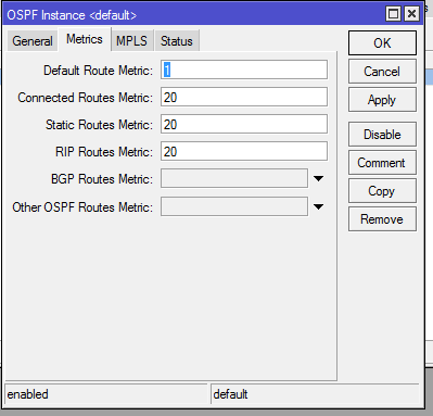

Adjust Default Route Import Metric ?
I tried default route metric changed to 20 but it did not change anything on the routing table
