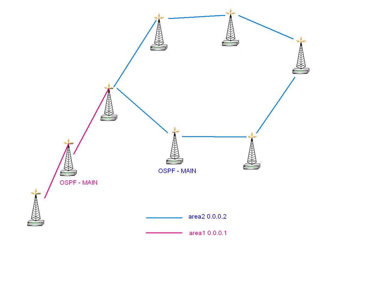

i have a network like this and for now im runnig rip-routing but now i wanna to close my network and go to ospf routing..
so now i have set to 2 areas…
area1 and area2 - the main ospf settings are the same and look like this:
router-id: 10.0.1.0 <---- on area2 is 10.0.2.0

and now when i configure all routers the area1 is working ok but the area2 is not.
from area1 i can only ping to area2 to 3. ospf gateway..
what i have done wrong??

you need a static route when transversing areas, you should redistribute the statics, and … why do you need two areas for this config?

It is best practice to set redistribute to the same type within an OSPF Area. You either redistribute as type-1 or type-2 and be consistent within that OSPF Area. Do not mix types.
ok tnx..i have now set all my ospf gateway routers to redistribute static and rip as-type2..
now i will try to set all routers from area2 to area1 and will replay the result’s
