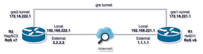

I have several routers, RB4011 and Hap AC3, with a GRE tunnel built between them.

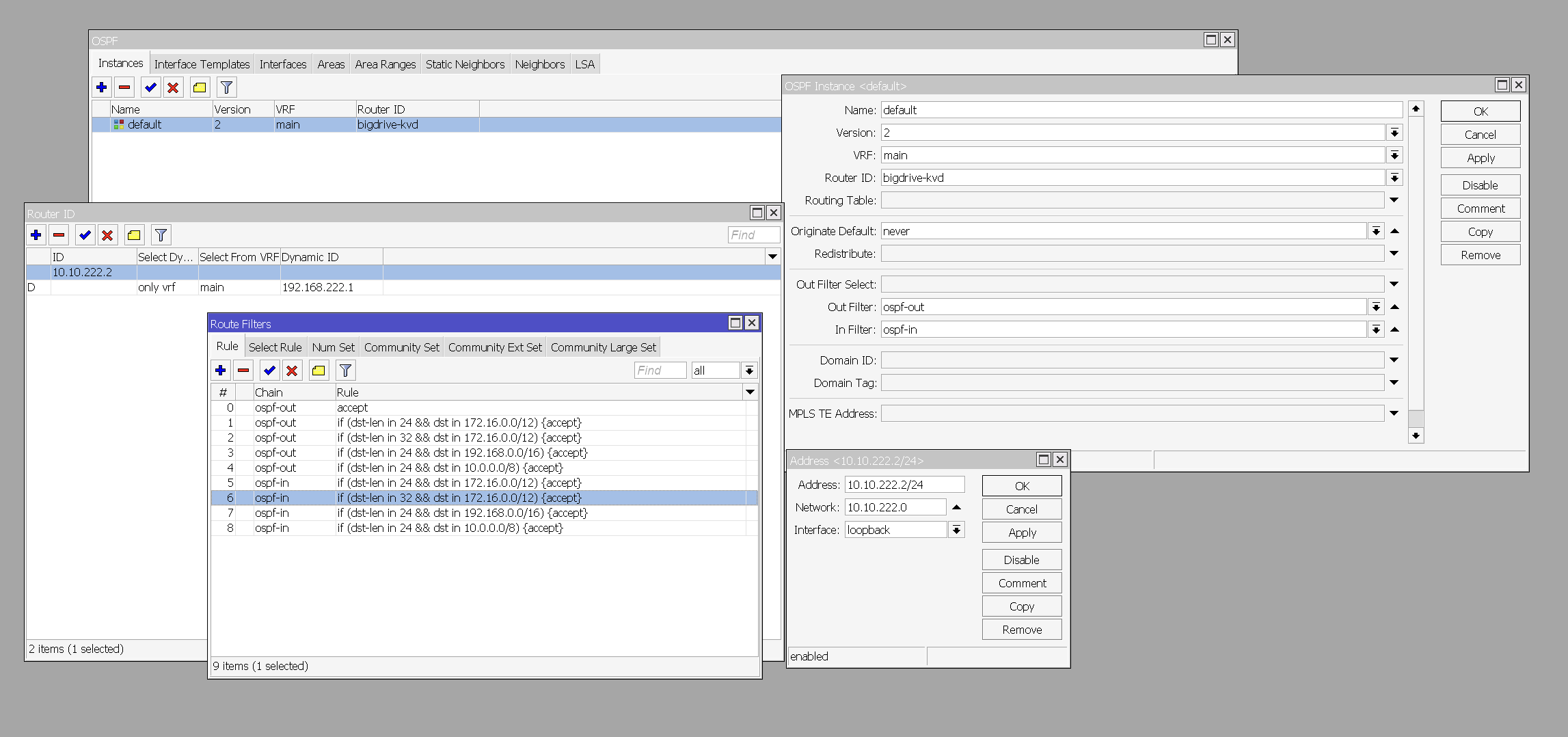

Also, please see the block diagram:

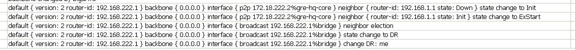

Log Ros V7
What are the options for solving the problem?

Log with CHR
19:57:57 route,ospf,info default { version: 2 router-id: 10.255.254.1 } backbone { 0.0.0.0 } interface { broadcast 192.168.254.1%bridge-local } neighbor election
19:57:57 route,ospf,info log-ospf: default { version: 2 router-id: 10.255.254.1 } backbone { 0.0.0.0 } interface { broadcast 192.168.254.1%bridge-local } neighbor election
19:57:57 route,ospf,info default { version: 2 router-id: 10.255.254.1 } backbone { 0.0.0.0 } interface { broadcast 192.168.254.1%bridge-local } state change to DR
19:57:57 route,ospf,info log-ospf: default { version: 2 router-id: 10.255.254.1 } backbone { 0.0.0.0 } interface { broadcast 192.168.254.1%bridge-local } state change to DR
19:57:57 route,ospf,info default { version: 2 router-id: 10.255.254.1 } backbone { 0.0.0.0 } interface { broadcast 192.168.254.1%bridge-local } change DR: me
19:57:57 route,ospf,info log-ospf: default { version: 2 router-id: 10.255.254.1 } backbone { 0.0.0.0 } interface { broadcast 192.168.254.1%bridge-local } change DR: me
19:57:57 route,ospf,packet log-ospf: default { version: 2 router-id: 10.255.254.1 } backbone { 0.0.0.0 } interface { broadcast 192.168.254.1%bridge-local } send hello
19:57:57 route,ospf,debug log-ospf: default { version: 2 router-id: 10.255.254.1 } backbone { 0.0.0.0 } lsa { router originator: 10.255.254.1 id: 10.255.254.1 seq: 0x80000002 csum: 0xc133 } originator u
pdate
19:57:57 route,ospf,debug log-ospf: default { version: 2 router-id: 10.255.254.1 } backbone { 0.0.0.0 } lsa { router originator: 10.255.254.1 id: 10.255.254.1 seq: 0x80000003 csum: 0xbf34 } flooding
19:57:57 route,ospf,packet log-ospf: default { version: 2 router-id: 10.255.254.1 } backbone { 0.0.0.0 } interface { p2p 172.18.254.2%gre-bigdrive-kv } send hello
19:57:59 route,ospf,packet log-ospf: default { version: 2 router-id: 10.255.254.1 } backbone { 0.0.0.0 } interface { p2p 172.18.254.2%gre-bigdrive-kv } neighbor { router-id: 10.10.222.1 state: ExStart }
send DD to 172.18.254.1 Init Master More sequence 1650449610
19:58:04 route,ospf,packet log-ospf: default { version: 2 router-id: 10.255.254.1 } backbone { 0.0.0.0 } interface { p2p 172.18.254.2%gre-bigdrive-kv } neighbor { router-id: 10.10.222.1 state: ExStart }
hello
19:58:07 route,ospf,packet log-ospf: default { version: 2 router-id: 10.255.254.1 } backbone { 0.0.0.0 } interface { broadcast 192.168.254.1%bridge-local } send hello
19:58:07 route,ospf,packet log-ospf: default { version: 2 router-id: 10.255.254.1 } backbone { 0.0.0.0 } interface { p2p 172.18.254.2%gre-bigdrive-kv } send hello
19:58:09 route,ospf,packet log-ospf: default { version: 2 router-id: 10.255.254.1 } backbone { 0.0.0.0 } interface { p2p 172.18.254.2%gre-bigdrive-kv } neighbor { router-id: 10.10.222.1 state: ExStart }
19:58:14 route,ospf,packet log-ospf: default { version: 2 router-id: 10.255.254.1 } backbone { 0.0.0.0 } interface { p2p 172.18.254.2%gre-bigdrive-kv } neighbor { router-id: 10.10.222.1 state: ExStart }
hello
19:58:17 route,ospf,packet log-ospf: default { version: 2 router-id: 10.255.254.1 } backbone { 0.0.0.0 } interface { broadcast 192.168.254.1%bridge-local } send hello
19:58:17 route,ospf,packet log-ospf: default { version: 2 router-id: 10.255.254.1 } backbone { 0.0.0.0 } interface { p2p 172.18.254.2%gre-bigdrive-kv } send hello
19:58:19 route,ospf,packet log-ospf: default { version: 2 router-id: 10.255.254.1 } backbone { 0.0.0.0 } interface { p2p 172.18.254.2%gre-bigdrive-kv } neighbor { router-id: 10.10.222.1 state: ExStart }
Log rom 5009
19:56:54 route,ospf,info log-ospf: default { version: 2 router-id: 10.10.222.1 } backbone { 0.0.0.0 } interface { p2p 172.18.254.1%gre-justhost } state change to Point-to-Point
19:56:54 route,ospf,debug log-ospf: default { version: 2 router-id: 10.10.222.1 } backbone { 0.0.0.0 } lsa { router originator: 10.10.222.1 id: 10.10.222.1 seq: 0x80000001 csum: 0x2455 } originator update
19:56:54 route,ospf,debug log-ospf: default { version: 2 router-id: 10.10.222.1 } calc start
19:56:54 route,ospf,debug log-ospf: default { version: 2 router-id: 10.10.222.1 } backbone { 0.0.0.0 } calc spt
19:56:54 route,ospf,debug log-ospf: default { version: 2 router-id: 10.10.222.1 } process summaries for default { version: 2 router-id: 10.10.222.1 } backbone { 0.0.0.0 }
19:56:54 route,ospf,debug log-ospf: default { version: 2 router-id: 10.10.222.1 } process externals
19:56:54 route,ospf,debug log-ospf: default { version: 2 router-id: 10.10.222.1 } install routes
19:56:54 route,ospf,debug log-ospf: default { version: 2 router-id: 10.10.222.1 } post process summaries
19:56:54 route,ospf,debug log-ospf: default { version: 2 router-id: 10.10.222.1 } calc done
19:56:59 route,ospf,debug log-ospf: default { version: 2 router-id: 10.10.222.1 } calc schedule
19:56:59 route,ospf,debug log-ospf: default { version: 2 router-id: 10.10.222.1 } backbone { 0.0.0.0 } lsa { router originator: 10.10.222.1 id: 10.10.222.1 seq: 0x80000002 csum: 0x386b } flooding
19:56:59 route,ospf,debug log-ospf: default { version: 2 router-id: 10.10.222.1 } calc start
19:56:59 route,ospf,debug log-ospf: default { version: 2 router-id: 10.10.222.1 } backbone { 0.0.0.0 } calc spt
19:56:59 route,ospf,debug log-ospf: default { version: 2 router-id: 10.10.222.1 } process summaries for default { version: 2 router-id: 10.10.222.1 } backbone { 0.0.0.0 }
19:56:59 route,ospf,debug log-ospf: default { version: 2 router-id: 10.10.222.1 } process externals
19:56:59 route,ospf,debug log-ospf: default { version: 2 router-id: 10.10.222.1 } install routes
19:56:59 route,ospf,debug log-ospf: default { version: 2 router-id: 10.10.222.1 } post process summaries
19:56:59 route,ospf,debug log-ospf: default { version: 2 router-id: 10.10.222.1 } calc done
19:57:04 route,ospf,packet log-ospf: default { version: 2 router-id: 10.10.222.1 } backbone { 0.0.0.0 } interface { p2p 172.18.254.1%gre-justhost } send hello
19:57:14 route,ospf,packet log-ospf: default { version: 2 router-id: 10.10.222.1 } backbone { 0.0.0.0 } interface { p2p 172.18.254.1%gre-justhost } send hello
19:57:17 route,ospf,packet log-ospf: default { version: 2 router-id: 10.10.222.1 } backbone { 0.0.0.0 } interface { p2p 172.18.254.1%gre-justhost } neighbor { router-id: 0.0.0.0 state: Down } hello
19:57:17 route,ospf,info default { version: 2 router-id: 10.10.222.1 } backbone { 0.0.0.0 } interface { p2p 172.18.254.1%gre-justhost } neighbor { router-id: 10.255.254.1 state: Down } state change to Init
19:57:17 route,ospf,info log-ospf: default { version: 2 router-id: 10.10.222.1 } backbone { 0.0.0.0 } interface { p2p 172.18.254.1%gre-justhost } neighbor { router-id: 10.255.254.1 state: Down } state chan
ge to Init
19:57:24 route,ospf,packet log-ospf: default { version: 2 router-id: 10.10.222.1 } backbone { 0.0.0.0 } interface { p2p 172.18.254.1%gre-justhost } send hello
19:57:27 route,ospf,packet log-ospf: default { version: 2 router-id: 10.10.222.1 } backbone { 0.0.0.0 } interface { p2p 172.18.254.1%gre-justhost } neighbor { router-id: 10.255.254.1 state: Init } hello
19:57:27 route,ospf,info default { version: 2 router-id: 10.10.222.1 } backbone { 0.0.0.0 } interface { p2p 172.18.254.1%gre-justhost } neighbor { router-id: 10.255.254.1 state: Init } state change to ExSt
art
19:57:27 route,ospf,info log-ospf: default { version: 2 router-id: 10.10.222.1 } backbone { 0.0.0.0 } interface { p2p 172.18.254.1%gre-justhost } neighbor { router-id: 10.255.254.1 state: Init } state chan
ge to ExStart
19:57:27 route,ospf,packet log-ospf: default { version: 2 router-id: 10.10.222.1 } backbone { 0.0.0.0 } interface { p2p 172.18.254.1%gre-justhost } neighbor { router-id: 10.255.254.1 state: ExStart } send
DD to 172.18.254.2 Init Master More sequence 1712849818
19:57:32 route,ospf,packet log-ospf: default { version: 2 router-id: 10.10.222.1 } backbone { 0.0.0.0 } interface { p2p 172.18.254.1%gre-justhost } neighbor { router-id: 10.255.254.1 state: ExStart } send
19:57:34 route,ospf,packet log-ospf: default { version: 2 router-id: 10.10.222.1 } backbone { 0.0.0.0 } interface { p2p 172.18.254.1%gre-justhost } send hello
19:57:37 route,ospf,packet log-ospf: default { version: 2 router-id: 10.10.222.1 } backbone { 0.0.0.0 } interface { p2p 172.18.254.1%gre-justhost } neighbor { router-id: 10.255.254.1 state: ExStart } send
19:57:37 route,ospf,packet log-ospf: default { version: 2 router-id: 10.10.222.1 } backbone { 0.0.0.0 } interface { p2p 172.18.254.1%gre-justhost } neighbor { router-id: 10.255.254.1 state: ExStart } hello
19:57:42 route,ospf,packet log-ospf: default { version: 2 router-id: 10.10.222.1 } backbone { 0.0.0.0 } interface { p2p 172.18.254.1%gre-justhost } neighbor { router-id: 10.255.254.1 state: ExStart } send
19:57:44 route,ospf,packet log-ospf: default { version: 2 router-id: 10.10.222.1 } backbone { 0.0.0.0 } interface { p2p 172.18.254.1%gre-justhost } send hello
19:57:47 route,ospf,packet log-ospf: default { version: 2 router-id: 10.10.222.1 } backbone { 0.0.0.0 } interface { p2p 172.18.254.1%gre-justhost } neighbor { router-id: 10.255.254.1 state: ExStart } send
19:57:47 route,ospf,packet log-ospf: default { version: 2 router-id: 10.10.222.1 } backbone { 0.0.0.0 } interface { p2p 172.18.254.1%gre-justhost } neighbor { router-id: 10.255.254.1 state: ExStart } hello
19:57:52 route,ospf,packet log-ospf: default { version: 2 router-id: 10.10.222.1 } backbone { 0.0.0.0 } interface { p2p 172.18.254.1%gre-justhost } neighbor { router-id: 10.255.254.1 state: ExStart } send
19:57:54 route,ospf,packet log-ospf: default { version: 2 router-id: 10.10.222.1 } backbone { 0.0.0.0 } interface { p2p 172.18.254.1%gre-justhost } send hello

hello,
I set up the fire wall rule right away, turned on logging and noticed one peculiarity, for some reason traffic goes through the external interface, although it should not go there, it should go inside the protocol gre
from your latest ospf log …
19:58:17 route,ospf,packet log-ospf: default { version: 2 router-id: 10.10.222.1 } backbone { 0.0.0.0 } interface { p2p 172.18.254.1%gre-justhost } neighbor { router-id: 10.255.254.1 state: ExStart } send
that would be impossible for the ospf to have split routing.
exstart means both ospf routers are in touch.
your previous log even said dr/bdr election: me - that means there are no split routing. the ospf router are ok but the mtu is too small.
if your isp has icmp filter along the path - that could be overcome with fragmentation set to yes.
there are ospf interface passive options - but i don’t think that it will help. neither with ip route rule/pbr to direct the ospf hello to go into the tunnel.
hmm… how about injecting a static route with Lower metrics than those to internet, on both router to be used by the ospf?
ok. have a try and good luck :+1:t2: I’m off for rest.
