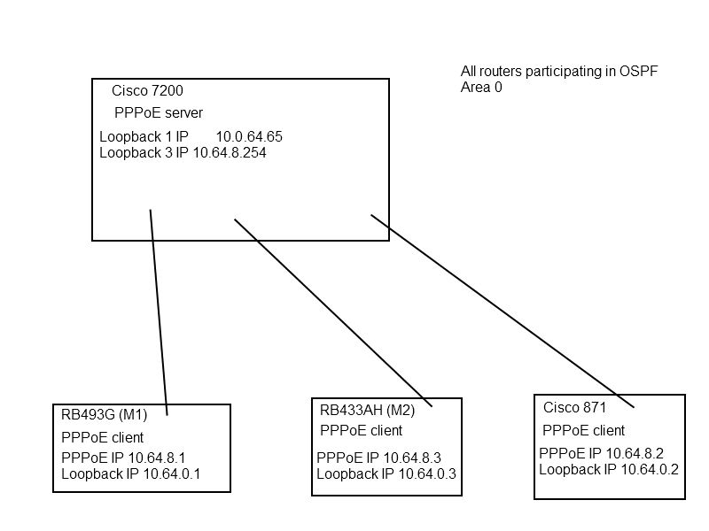

I’m having a rather odd issue and wanted to see if anybody has done or tried anything similar.
I have a Cisco 7200 running 12.2SRE acting as PPPoE LAC/LNS and OSPF router. I also have 3 PPPoE clients: 1x Cisco 871, 1x RB493G and 1x RB433AH. The 871 is running 12.4(24)T3 and the RB units are running 5.5
I am then trying to get OSPF working over the PPPoE connection, I am able to get neighbors to come up between the LNS and each PPPoE client. While OSPF comes up I am having some issues with the routes being installed into the routing table on the MikroTik clients. The routes do appear in the OSPF database, however for some reason they do not appear in the regular routing table. The Cisco CPE works just fine and the Cisco LNS correctly installs routes from the MikroTik clients into its routing table also.
