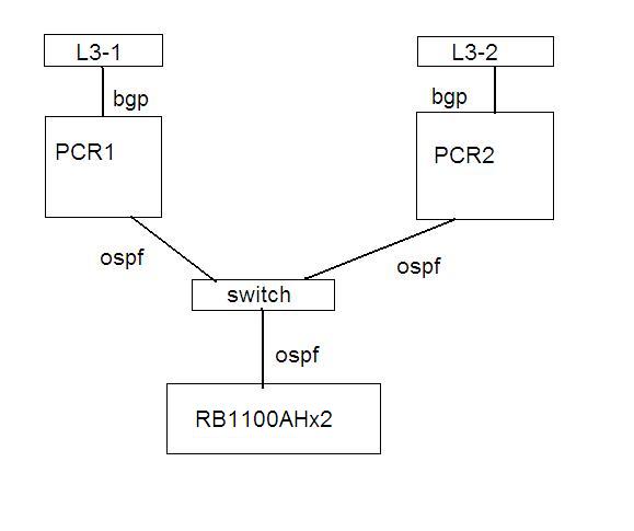

Welcome all!
I have a problem on the network using OSPF with Mikrotik RB1100AHx2.
There are two border routers, cisco switches and Mikrotik RB1100AHx2, v 5.22, they are working by the protocol OSPF
Border routers are also BGP-connection upstream provider
In the case where the main BGP-connection is lost, cisco switches receive the default route and continue to work, but mikrotik does not get default route.
On closer examination, found that the neighborship established on FULL-state, LSA from the backup border router received:
routing ospf lsa print
AREA                                                                                                                    TYPE         ID             ORIGINATOR     SEQUENCE-NUMBER        AGE
backbone                                                                                                                router       10.10.1.15     10.10.1.15          0x80000030        392
backbone                                                                                                                router       192.168.10.1   192.168.10.1        0x800000ED        624
backbone                                                                                                                router       192.168.10.2   192.168.10.2        0x800000EA        621
backbone                                                                                                                network      192.168.10.2   192.168.10.2        0x80000031        632
external                                                                                                                as-external  0.0.0.0        192.168.10.2        0x80000030       1242
external                                                                                                                as-external  192.168.100.255 192.168.10.1        0x800000EB        634
external                                                                                                                as-external  192.168.100.255 192.168.10.2        0x800000EA       1239
external                                                                                                                as-external  192.168.10.255 192.168.10.1        0x800000EB        634
external                                                                                                                as-external  192.168.10.255 192.168.10.2        0x800000EA       1239
but routing table protocol OSPF default route does not get:
routing ospf route  print
# DST-ADDRESS        STATE          COST                                                                GATEWAY         INTERFACE
0 192.168.100.0/24    ext-2          20                                                                  192.168.10.1    ether6
                                                                                                         192.168.10.2    ether6
1 192.168.10.0/24    intra-area     10                                                                  0.0.0.0         ether6
If this scheme is going for the first time, everything works:
ip ro pr
Flags: X - disabled, A - active, D - dynamic, C - connect, S - static, r - rip, b - bgp, o - ospf, m - mme, B - blackhole, U - unreachable, P - prohibit
0 ADo  0.0.0.0/0                          192.168.10.1            110
                                           192.168.10.2
but after the first break - does not get default route
Please help me…
