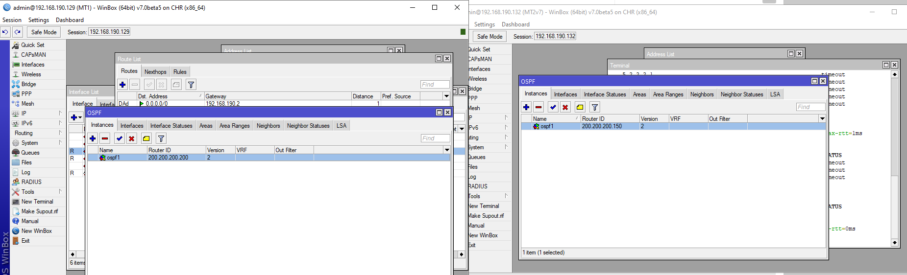

OSPF Instance list:

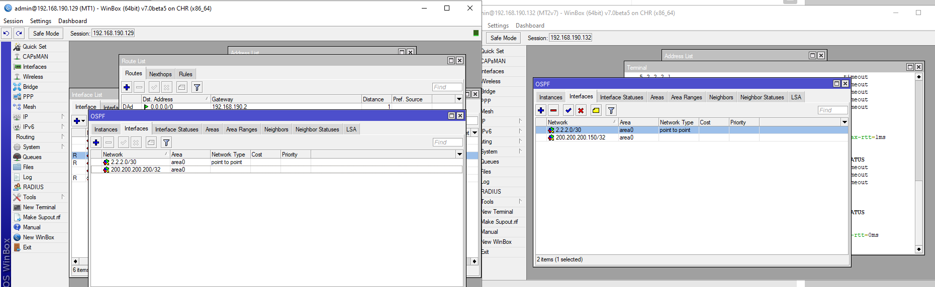

OSPF Interfaces list:

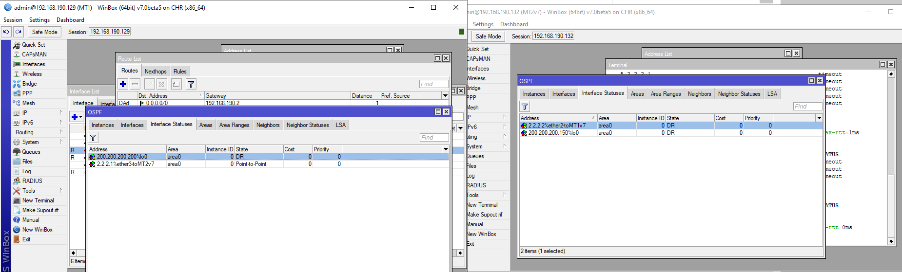

OSPF Interface statuses:

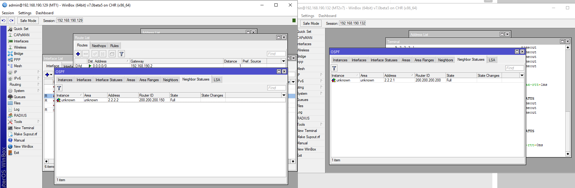

OSPF Neighbors list:
OSPF Neighbor Statuses:

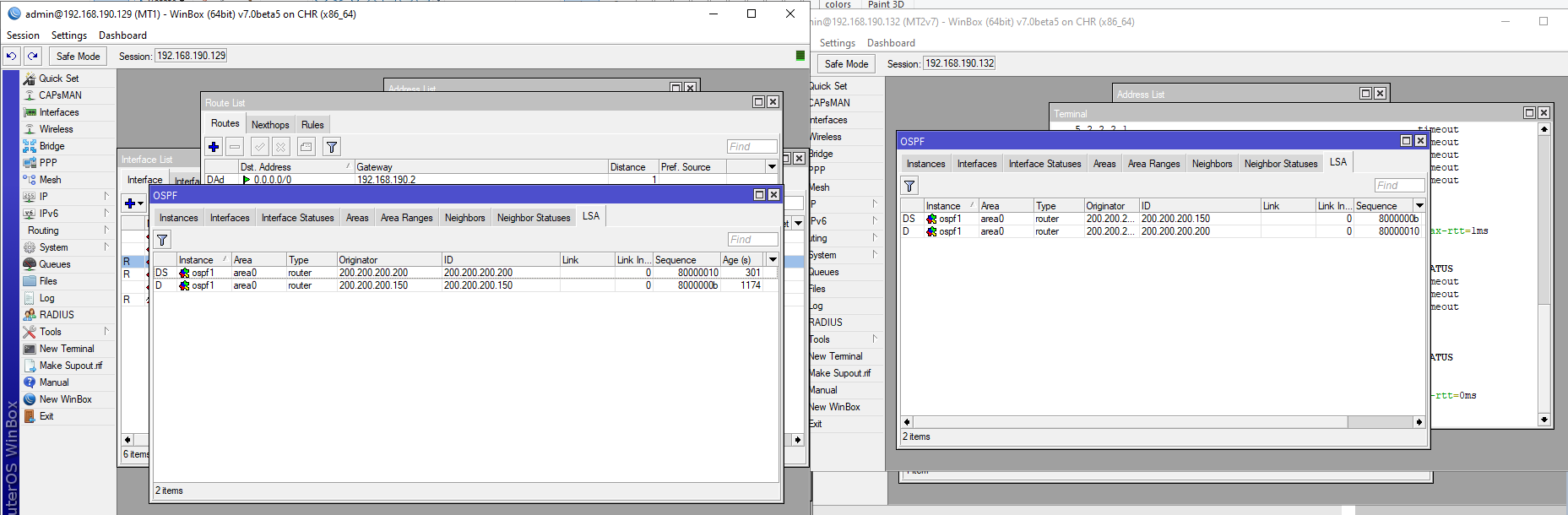

OSPF LSA list :

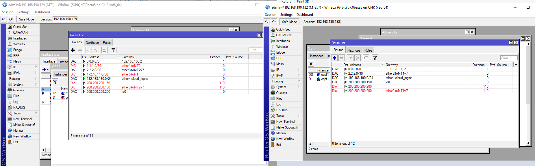

In the ip route list the ospf routes are DIo - Dynamic Invalid OSPF like on the picture below :

Yes, I had encountered this above issue. I figure it is actually caused by the missing “gateway” setting. IPv6 BGP has the same issue - missing “gateway” causes the route to be invalid, since how can a route have no gateway?
