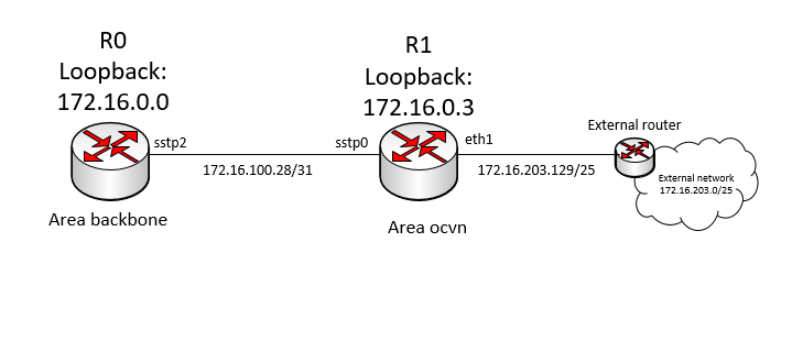

Hello. I’ve configured redistribution of static route (172.16.203.0/25) on router R1 to OSPF.
Then i see that this route is disappearing every 5-10 sec. on router R0.

Some config from R1
[admin@R1] /routing ospf> export
/routing ospf area
add area-id=172.16.0.3 name=ocvn
/routing ospf instance
set [ find default=yes ] redistribute-static=as-type-1 router-id=172.16.0.3
/routing ospf interface
add interface=sstp0 network-type=point-to-point
/routing ospf network
add area=ocvn network=172.16.100.28/31
add area=ocvn network=172.16.0.3/32
add area=ocvn network=172.16.203.0/24

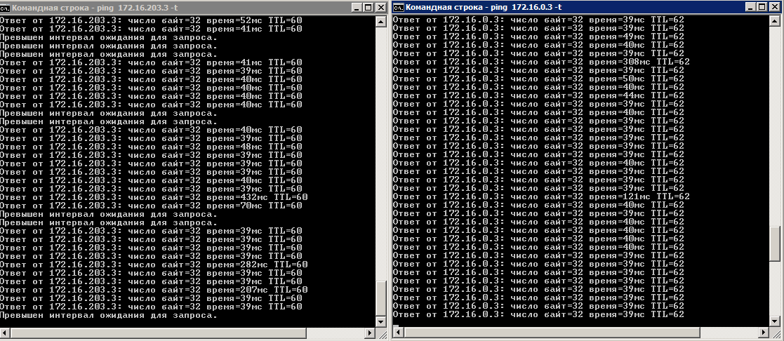

So, I see packet loss to the host 172.16.203.3
Please tell me, what is wrong? How to fix it?
