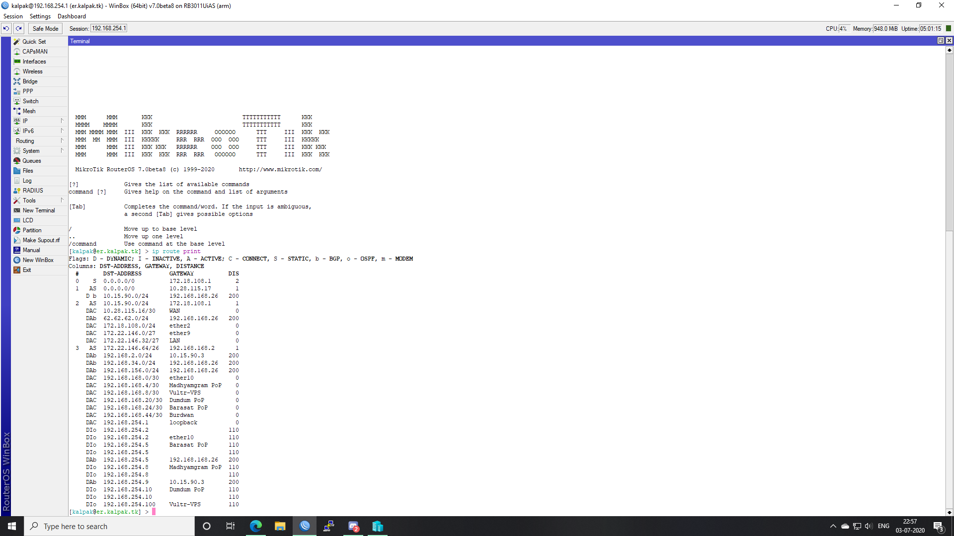

OSPF routes marked invalid
I have established ospf neighborship with other mikrotik routers yet the ospf routes learnt are marked as invalid on the router running rosv7 beta 8
config.rsc (10.4 KB)
