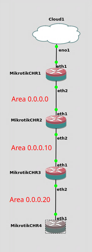

OSPF second area
Hello everyone,

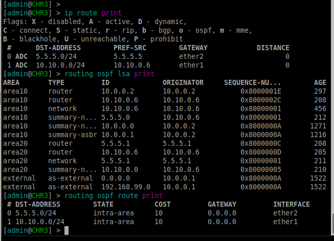

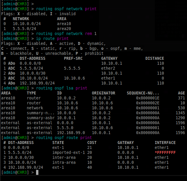

with GNS3 I have simulated a small network area that also causes problems on a large scale. the ROS version used is 6.48.3, which is the latest stable. The problem occurs when I set up a second OSPF area on the Mikrotik (CHR3). Then no more OSPF routes can be found via “ip route print”, but the routes are still listed via “routing ospf lsa print”. As soon as I remove the second area, the routes are back.
If I replace the Mikrotik with a Cisco, the problem does not exist and everything works.
Here the configs.

here an screenshot with
and without the OSPF network entry

What you are posting violates the operational rules of OSPF and will not work properly
OSPF requires all area’s to directly connect to the backbone/Area0
In your example, area 20 is not connected to area 0
You can bend this rule with ‘virtual links’ to form a tunnel between area0 and area20, however this is not recommended and will not result in the type of traffic flow you would logically expect
In order for area20 to talk to area10 for instance, it will traverse Area20->Area0->Area10
