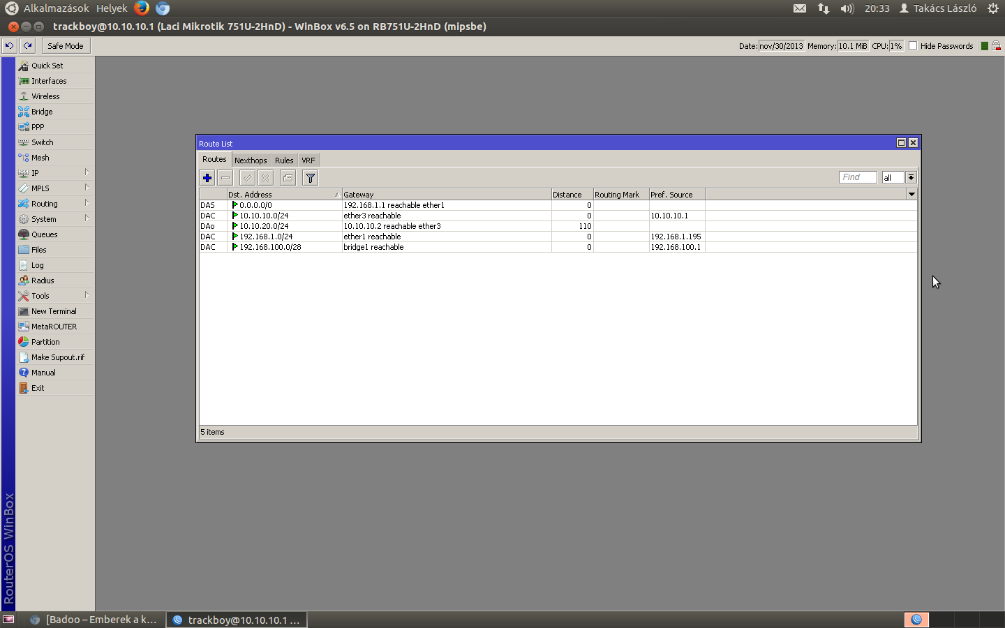

Hello,so i try out without areas, at the moment the backbone network is:10.10.10.0/24
RB 751:10.10.10.1/24=Ether3, and there is dhcp-client on Ether1 interface=192.168.1.195/24, dns-server is:192.168.1.1
RB 951:10.10.10.2/24=Ether1
On RB 751 enabled: redistribute-connected routes=as-type 1 and redistribute the default route= always as type 1
On RB 951 enabled: redistribute-connected routes=as type 1
There is a connected network on RB 951 wlan’s interface:10.10.20.0/24 (wlan’s interface ip address is:10.10.20.1/24
And the NAT in the RB 951:10.10.20.0/24: ip firewall nat src-address=10.10.20.0/24 out-interface=ether1 action=masquerade
If the 751 is acting as your border router then you should NAT on there.
I don’t think you need a NAT at all on the 951

Anyway i took your advice:at the moment i need to NAT in the RB 751:10.10.20.0/24,and i can connect to the Internet,and no need to NAT in the RB951
I just want to develop my networking knowledge,i have got a test network with some Mikrotik devices.
So at the moment my RB 751 is the AS system boundary router,and i need to NAT just in this router
