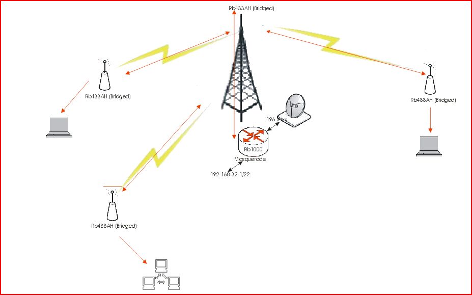

i have a wireless network that consist of 15 routers (rb433AH). all routers are bridged to a rb1000. i need to change the network structure from bridged to routing. i want to use OSPF. can any one please guide me on a simple OSPF setup for my network?

uumar, where are you from? do tou have a ìmage of the network? i think that if you have a star-àtype network, static routing work fine for you!
hi MichelePietravalle
here is the image of my network. from the diagramme, all client pc gets ip address direct from the edge router (rb1000). all other routers are bridge to the edge router. i need to change this structure to a routed network.
thanks
assuming you have IP’s on all the edge RB433’s you could start by just removing the ethernet interface from the bridge and assigning a static IP and dhcp server for the end user.

thanks for your post. i actually tried the ospf but did not work. what do you mean by adding the two networks?
maybe i was not doing it right. this is an example of what i have
on the rb 433 in removed the eth1 from the bridge and then
configure 192.168.32.10/24 on eth1
configure 10.5.50.1/24 (and dhcp server) on wlan for the clients.
how do i configure ospf for such sutep? remember that my edge router ip is 192.168.32.1.

So wait, you’re using wireless to the edge clients as well as wireless back to the base station and then to the RB1000?
So: assuming each RB433 you’re using has 2 wireless cards?
If this is the case you want to remote the 1 wireless card that is serving the local clients, from the bridge.
Then give it the ip address and dhcp server you want it to have.
Then go into routing → ospf → networks and add 10.5.50.0/24 (your local network) then X.X.X.X/24 (your backhaul network)
you then need to do the same on the wireless AP this device is connecting back to, so it can receive the routing updates and “learn” what routes the client AP has.

im using a rb433 point-to-point from one base station to another, then another rb433 as AP for the edge client. i want the point-to-point to remain bridged. i want the APs to be routed.
Also, do i have to be adding ospf network on the edge router for all the APs? i have 10 different Aps.
